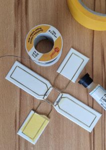

  9. 0.8 Brass wire

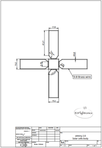

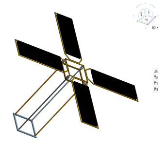

As a first step, I draw in OnShape how the satellite structure should look like, having in mind the solar-cells dimensions and the final size I was aiming for. Almost all of the dimensions are related to the solar cells size and implemented as variables so in case a different solar cell form factor is needed it only takes to change two values and the 3D design will update itself to allocate the new cells. I am planning to play with this in the near future and do a micro version variant without having to go through the whole process again. The jigs are also automatically calculated and generated!
A 1:1 PDF is included in my GitHub repo (sAttiny2_0_Panel_Body_Guide.pdf). It can be used as a reference if printed at 1:1 scale.

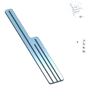

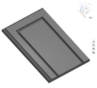

Step 3: Wire Jig
For this project there are three main wire lengths that are needed. To make sure consistency is achieved, this jig facilitate the task of working always with the same lengths.

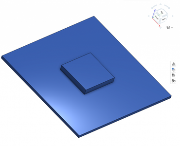

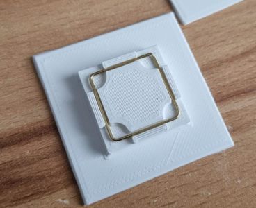

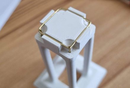

Step 4: Square Jig
Used to create the three squares that belong to the main body structure. We can start with this form first followed by the four sides wit hthe help of the side jigs.

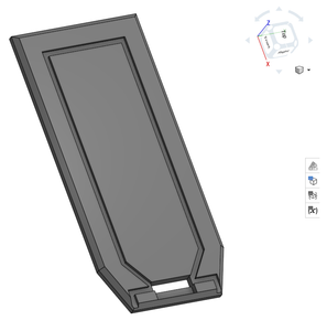

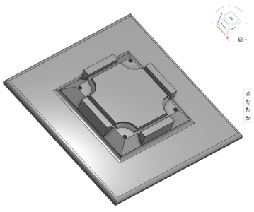

Step 5: Side Jig
Used as a guide for the 4 sides that are going to hold the solar panels. The squared shape made in the previous step can be soldered to the first two sides withe the help of this jig.

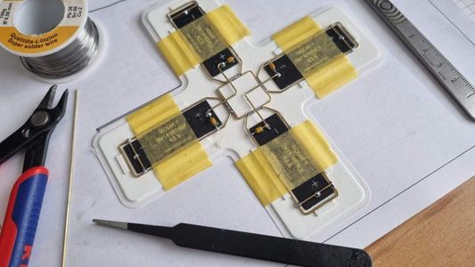

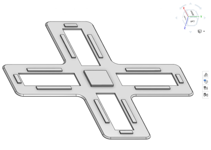

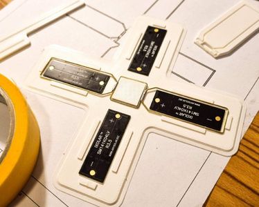

Step 7: Panels Jig
This jig helps to get the frame in place with the right position so the solar cells can be soldered easily and on their correct position. We can always go back to the 1:1 pdf and check if the results are aligned with the reference ;)
Notice that small axial capacitors are used to provide strength to the structure without making a short between unwanted parts ;) The same concept is used when joining the two main body parts.

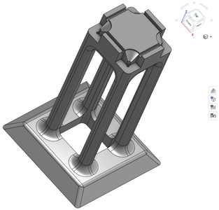

Step 8: Body Jig 1
Once the panels are in place we can start with the satellite´s body. This jig provides the required support to solder the first part of the main body.
Step 9: Body Jig 2
The last jig provides support for soldering the bottom side of the main body
