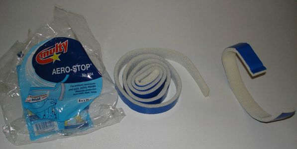

Step 1: Grab Some Aero-stop Tape

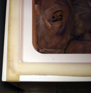

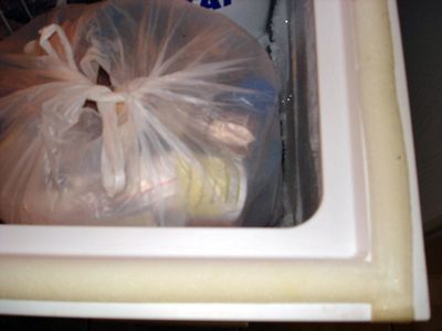

I used some aero-stop tape to cushion the gasket where it meets the freezer lips.
This stuff is used at doors, windows etc to insulate any slits or holes that allow heat/cold to escape. It easily cut using scissors.
I encircled the lips of the freezer.
