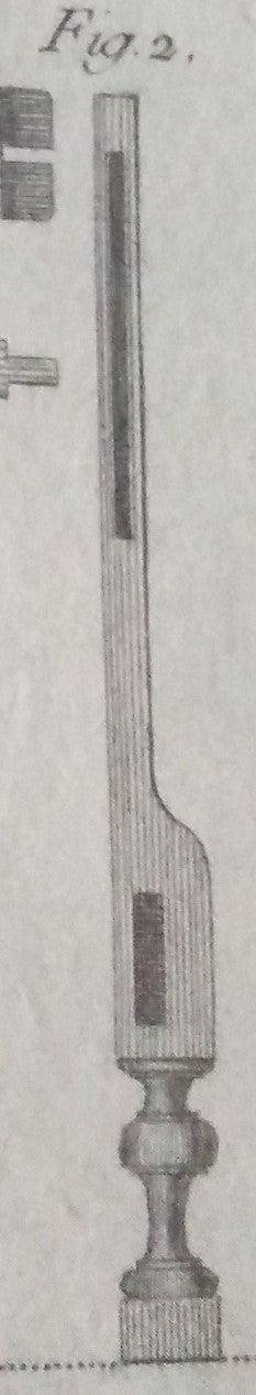

Step 8: Leg Design

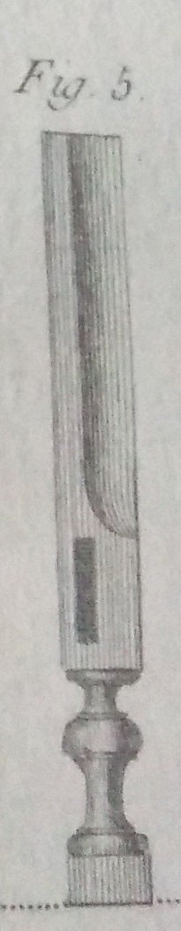

Roubo says to cut both headboard legs from the same piece of wood with the feet included to prevent waste, I found it cumbersome and opted to turn the feet separately and do each leg separately. I know I just said waste is your enemy... but still... you know...

Fabrication starts yay!!! I started with the legs, get them to size. The headboard legs are 37" long, the foot legs are 34" and all 3"x3". Then pick the show face and mark them.
The last 12" of the head legs are 1 1\2" thick but don't cut it yet! Draw everything first, they will receive the stiles with a single tenon held by 2 pegs, then the rails which have a double tenon and a bolt through the middle, then the panels that have a single tenon and 3 pegs.

Step 12: Foot Legs
The foot legs are scooped on the upper 12inches, this was done so you could slip your hand comfortably between the foot and the matress to make the bed. To do this I used my fathers chop saw which has a 8 1/4in blade, it's the closest I could get to the right radius without scooping it out with a chisel.
