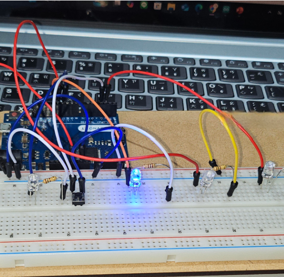

Step 2: Set Up the Electronics
Attach the Ultrasonic Sensor inside the bin where it can detect when a carton is dropped in.
Connect 5 LED lights in a row on the outside of the bin.
Attach a Servo Motor to a small candy holder or door that can release one candy.
Connect everything to an Arduino (or other microcontroller) using jumper wires and a breadboard.

Carton Detection – Ultrasonic Sensor (e.g., HC-SR04)
Ultrasonic Pin Arduino Pin
VCC -------------5V
GND -------------GND
Trig --------------7
Echo ------------6
šŸ’” LED Indicators (5 LEDs)
LED Number Arduino Pin
LED 1----------- 3
LED 2----------- 4
LED 3----------- 2
LED 4----------- 5
LED 5----------- 8
šŸ”§ Each LED should be connected in series with a 220Ī© resistor to protect the LED.
šŸ¬ Candy Dispenser – Servo Motor
Servo Pin Arduino Pin
VCC ----------5V
GND ---------GND
Signal -------10
