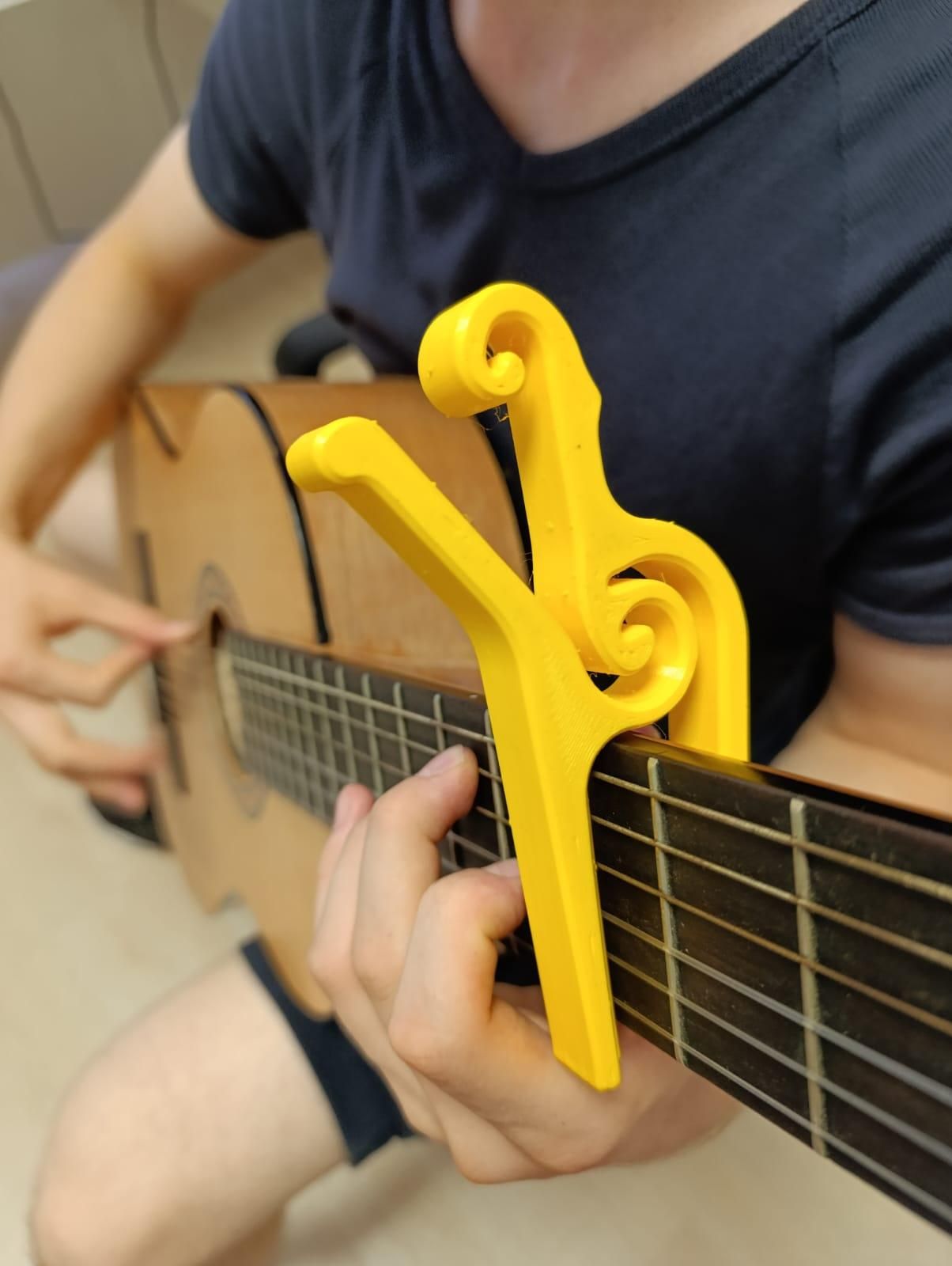

Also for the ones interested in priting guitar accesories for themselves, I have a MakerWorld account that I publish functional models for 3D prining including "OZAN Guitar Footstep". Linked below!
