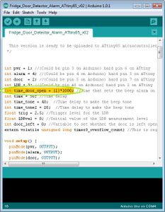

Step 6: Setting the Alarm Time
The only thing that you would like to change in the code is the time that is needed befor the buzzer starts making beep sounds after you open the fridge door.
On line 16 in the code, there is a variable called time_door_open.
It determines this time after you open the door and until you hear the beep sound. It depends on the clock frequency how many seconds the delay will be. I wrote 1000, which on the Arduino Uno would mean 1000 milliseconds = 1 second. But on the ATtiny this is about 9-10 seconds.
Set this variable to the suitable time that you want the delay to be!
int time_door_open = (3)*1000 will make the delay 25 seconds.
