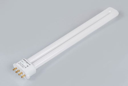

This is a mini instructable about the conversion of my fridge light from the original fluorescent lamp to LED. Why? Well, I've had the fridge/freezer for about 18 years now an I've had to replace the fluorescent lamp every 2-3 years. I guess the repeated opening/shutting of the doors along with cool temperatures and possibly some condensation means the life of these lamps is very short, particularly when you consider the lamp is only on for a few seconds/day.
The lamp is both difficult to obtain and very expensive. A quick look online reveals a AU$29.95 to AU$41.95 (US $21 - $30 roughly)
Here are a couple of links for this Samsung part (4713-000175)

The existing fluorescent tube is driven from an inverter on top of the fridge. I removed this part and replaced it with a wall wart style plug pack. The LED strip replaced the fluorescent tube inside the fridge, I actually used a couple of different types as the first strip gave a slightly odd colour/hue change in comparison to the original cool white of the fluorescent.
