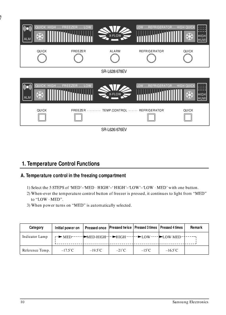

As mentioned in the 1st step the idea is to lower the temperature setting of the fridge/freezer compartments to "pre-load" the contents with coolth (yes, that is a real word), and then change it to a higher set point when you want to minimise the electricity usage. Initially I wrote the software to have the period of (hopefully) low electrical usage to coincide with the peak rate charges (2pm-8pm). As I said in the last step, this was to my advantage as I have a solar installation and I was being paid a generous (some say over generous) rate for the power I exported to the grid. That scheme has now changed and it is no longer a gross FiT but a net FiT so I've recently changed the timings in the software to change things around.
The fridge temperature can be changed by pushing the buttons on the fridge door - the temperature range is -21 to -16.5Deg C for the freezer and -1 to +6 for the fridge. All I need to do is identify the wires from the buttons and wire some relays in parallel....
Step 4: "Faking" the Push Buttons on the Fridge Door
To get the Arduino to do the equivalent of pressing the buttons on the fridge door I had to do some more investigating and find out how/where the wiring was organised for these 2 functions. Once I had discovered which wires it was it was a relatively simple task to splice in wires in parallel with these buttons

Basically, on powering up the Arduino asks the RTC for the date and time and based on this information it synchronizes the fridge temperature. (The fridge always boots up with both fridge and freezer set to the mid temperature point).
From this point on-wards the program loops continuously (for ever) just polling the RTC for the updated date and time information. When a particular time period is reached the Arduino command the temperature to change by closing and opening the reed relay a set number of times, thus changing the temperature set point of the fridge/freezer.
