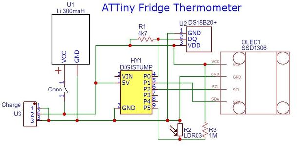

Step 1: Electronic Design
The schematic shows the design is very simple. The AT Tiny reads the temperature from the DS18B20 sensor using the OneWire interface on PB0 with a 4k7 resistor providing a pull up on the data line. Two outputs PB1 and PB2 drive the I2C display. The Light dependent resistor is biased by a resistor from the supply line and its voltage is measured by the ADC input on PB5. This allows detecting the door opening. With the fridge closed it is dark and the high reading sends the ATTiny into a sleep state and it occasionally wakes up to check if the fridge light has come on. A 1M value is used to minimise the current from the battery. I deliberately avoid using PB3 and PB4 as these provide the USB programmability and one has to be careful to avoid compromising that if external circuitry is attached.
A "switch" is also used in the battery supply line as the battery connection needs to be removed if a USB update is needed. I actually used a simple connector for this function. The battery is also brought out to a 3 pin connector so I can use an external Lithium charger to recharge the battery.

I mounted the DS18B20 pull up directly on its pins and the LDR bias was soldered onto a spare pad (from removed regulator) and wired across to PB5.
