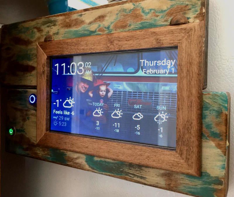

9 years ago when we moved into our house we had to cut down a small, dead, limbless maple tree that was left by the builders to qualify our lot as treed.
I saved some of the wood from that tree, knowing someday, just maybe I'd have a Pi project I could use it in... and here we are! A nice piece of wood from our first home history being made into the frame for the touch screen and Pi.
I hoped to give the frame a weathered board look, to match a really nice coat hook project my wife did.
I cut the length of maple board into two even boards and staggered them a few inches so the edges weren't uniform.
I created the opening for the touch screen by measuring the screen, including the position of the 4 screw tabs and drilling a pilot hole for my jigsaw blade, then cutting out the rectangle shape of the screen.
I drilled down on the two pieces of wood where the screen's screw tabs aligned just deep enough so that when installed, the screen's glass would sit slightly recessed from the surface of the wood (I wanted to put a wood edge frame around the edge of the screen).
I used my plunge router with a straight bit to remove maple from the two boards where the Pi would sit.
I set the depth so that the Pi would sit flush with the back of the maple boards so the GPIO pins wouldn't contact anything and still have enough maple on the front side to be strong.
Since the areas of the wood that were being removed were not going to be seen once the electronics were installed, I didn't spend a lot of time or effort making the cutting pretty.

Once dried (24h plus). I set the touch screen into the frame to check depth and positioning.
So far so good!
The 7" screen sits 1mm or so blow the surface of the maple board surface.
The Pi itself sits inside the rear hollowed our section of the board and the HDMI cable connection routes nicely between the PI and the screen.
Don't forget to peel off the protective film prior to attaching the edge frame in the next step! :)
Step 5: Step 5: Magnets Have Complex Relationships, Attractive or Repelling...
After verifying the positioning of the screen and the cables, I secured the touchscreen in place with 4 small screws.
I used good ol' PL construction adhesive to attache the mitered maple edge frame, stained with the same stain as the wood, around the screen.
Since the screen's screw tab holes are larger, I opted to place a wood frame around the screen, covering the holes and any other imperfections of the screen placement.
The only caveat was that two of the screws holes extended past the edge of the edge frame. No big deal, as I simply covered theses two spots with hardwood plugs, also stained dark. In hindsight, I should place two more hardwood plugs on the other side of the screen, creating symmetry.
Live and learn. :)

After configuring the Volumio Pi server, I setup the Pi that would be the main interface and be stuck the side side of our fridge.
The first thing I did was install the latest Raspbian (Stretch) from the Raspberry Pi website.
Screen Resolution
On the first boot, you'll notice the screen image quality looks like garbage. No worries! We just need to manually define the optimal resolution of 800x400 (note, your touch screen optimal resolution may be different).
