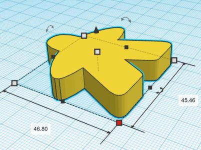

Step 1: Link Leader Buddy
  1. On TinkerCAD, scroll to shape generators --> all shapes --> more --> more
  2. Drag the "Carcassone" shape onto the build plate
  3. Change its dimensions to 45.46 mm wide, 9 mm tall, and 46.8 mm long, as shown in the image

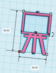

Step 3: Art Buddy
  1. Download the image attached to this step
  2. On a web browser, search for "[file type]* to STL converter" (I used this site)
  3. Download the new file
  4. On TinkerCAD, click "import" then select the new file and import it at 100% scale (there's a good chance it will be tiny at this point)
  5. Expand the image to 60 mm by 40 mm by 9 mm, as shown above
*I saved it as a PNG

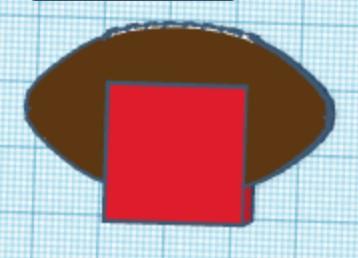

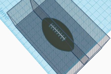

Step 4: Athletics Buddy
  1. On TinkerCAD, scroll to Fun & Games --> Sports
  2. Drag the "Football" onto the build plate
  3. Drag two "Boxes" (cubes), as found in Basic Shapes, onto the build-plate
  4. Make each one 123 mm by 39 mm by 71 mm and set them next to each other 1 mm apart
  5. Select both and hit the "Group" button on the top right
  6. Make that union a "hole"
  7. Using the "Align" button on the top right, align the group to the football as shown in the image above
  8. Use the "Group" button to merge the group with the football
  9. Rotate the football by 90 degrees then hit the "d" key so it is flat on the build-plate
  10. Adjust the football cutout's size to be 25 mm by 44 mm by 9 mm
  11. Insert another "Box" and adjust its sizing to 20 mm by 20 mm by 9 mm
  12. Using the "Align" tool, center it with the football, as shown above
  13. Merge the two using the "Group" tool
