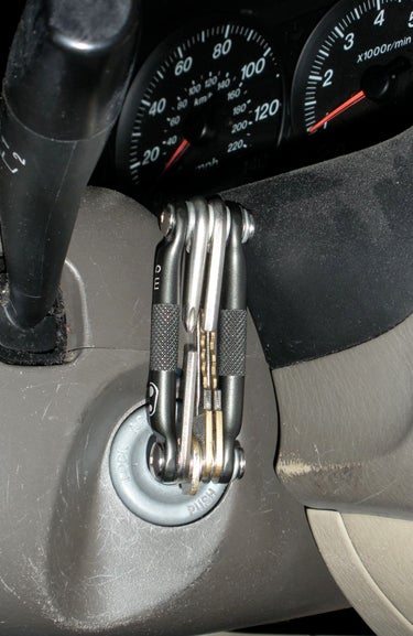

12 years ago on Introduction
i'd have to see how this looks in the ignition to be really hyped on it. i was excited until i imagined how that would work with a multi-tool hanging off your ignition...

reconscious
reconscious
Reply 12 years ago on Introduction
This is how it looks in my '02 Mazda Protege. After I start the car I fold it upwards so it's out of the way of my knee.
