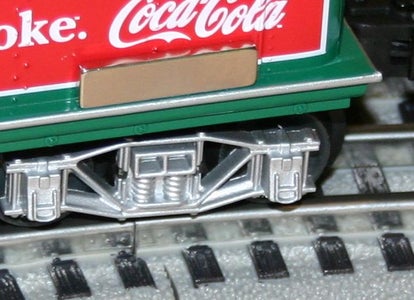

Using a reed relay (Jameco #111448) and a bar magnet glued to a train car, I was able to get my "variable stopping distance" down to about one inch.
Connect wire wrap wire across the relay contacts--the relay will close when the magnet is near.
