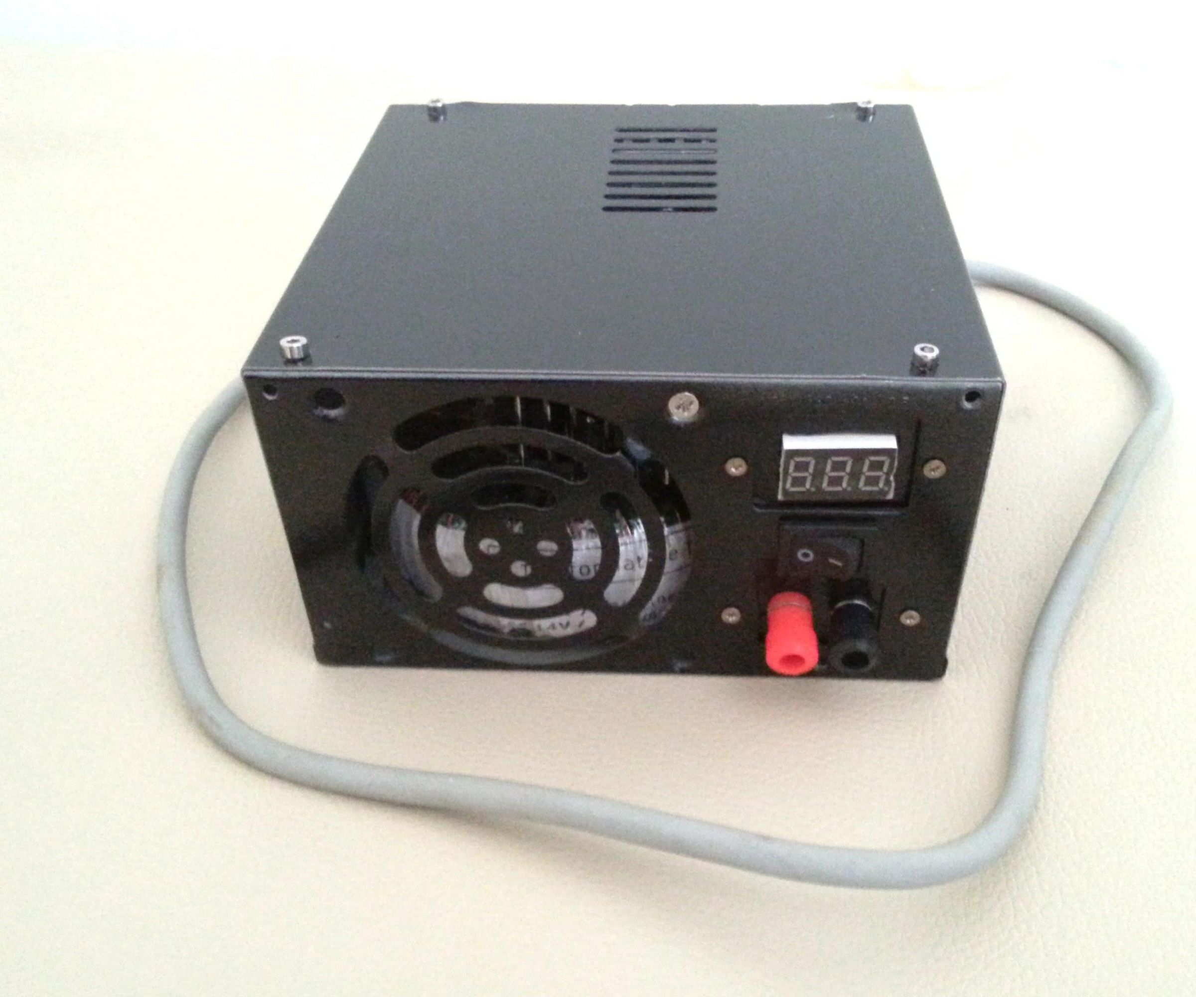

I must make one comment about the electrical power supply. Since the original compressor has a high current demand (up to 11 A idle, up to 15 A on working) a proper power supply is needed. For this purpose, using it at home I employed a modified PSU from an old PC. Nevertheless, in the standard 12 V the device doesn't work so I lowered to 5 V and in this way it worked.
Maybe, I may have lost a little bit in terms of motor speed (and then in the suction capacity) but the result seems satisfactory.
