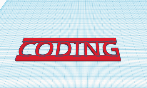

Slapons are small 3D printed picture that you can glue or tape on to things. In that way they work a lot like stickers and it can be a good idea to think of them a 3D printed stickers.
Because they are small and thin they can be printed fairly quickly. The one on the picture here takes 15 min to print on medium quality with my CR6 SE printer. A printer often found in schools here in Denmark.
That means that students can often design a slapon, print, redesign and print again during a single lesson. Making slapon texts requires using Tinkercad a bit more than making slapon pictures, so it can be a good activity for foææowing up on slapon pictures.

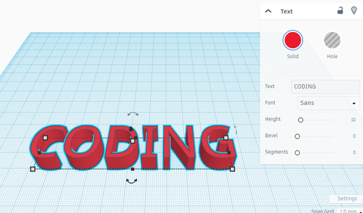

First make your text in Tinkercad. Write in all caps. You might want to rise the bevel a bit. In this example it is 0, but I often have it around 1, because I like the fatter letters. Scale it to the size you want it.

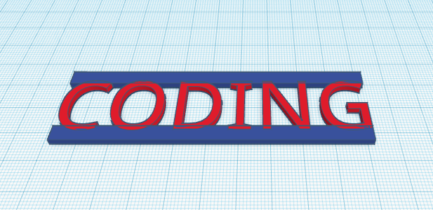

Then put a block above and a block belove the text. Make sure that they go into each other a bit and have the same height.

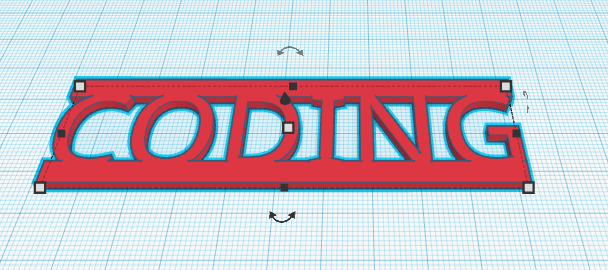

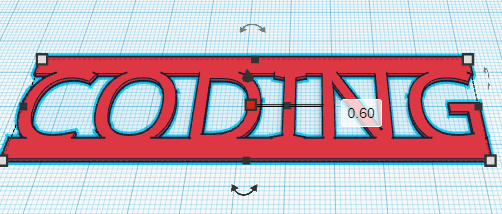

Then group the letters and two boxes together. Make sure that the figure have the correct size and then reduce the height to 0.6 mm.
Export the file. I normally export it as stl file.
