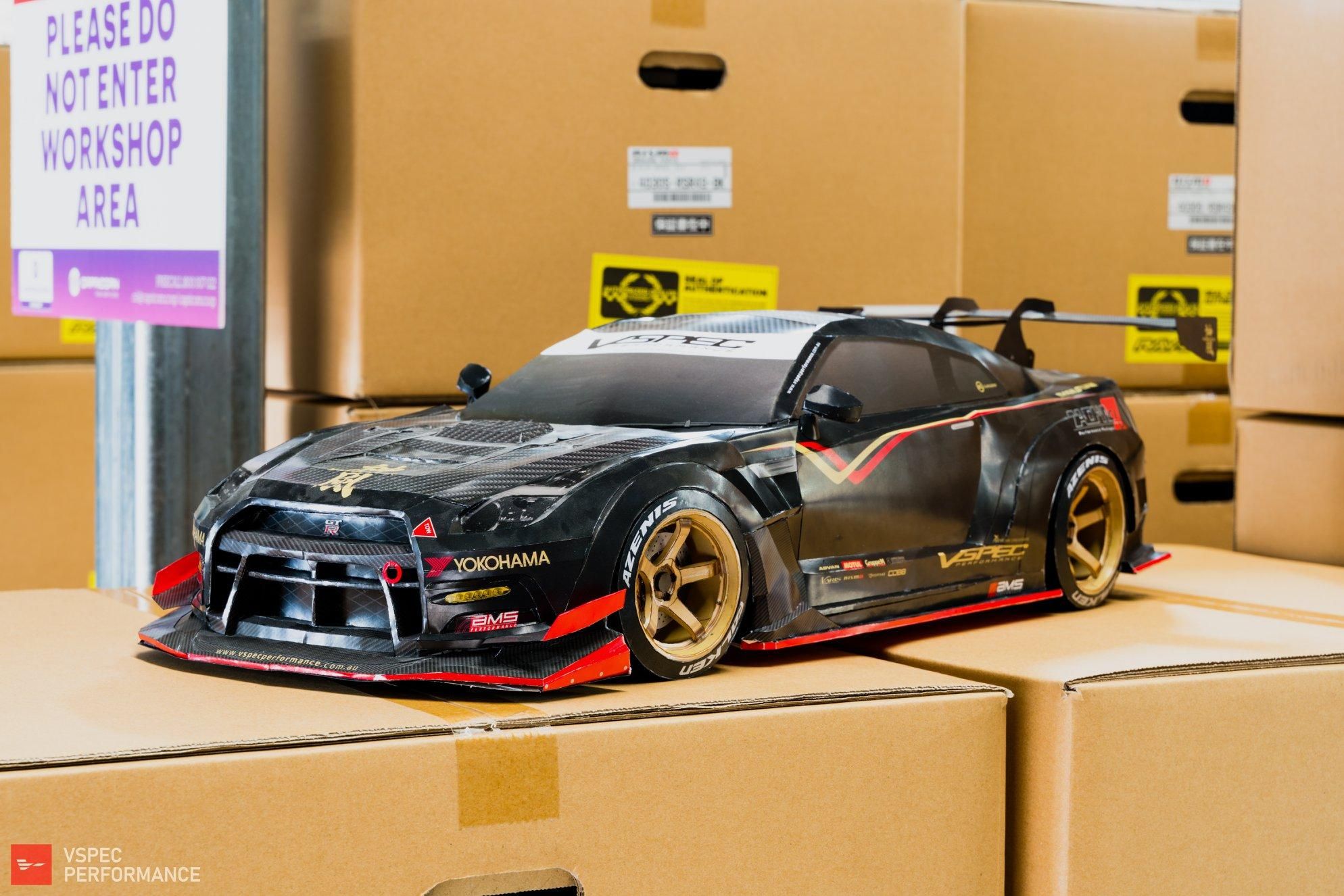

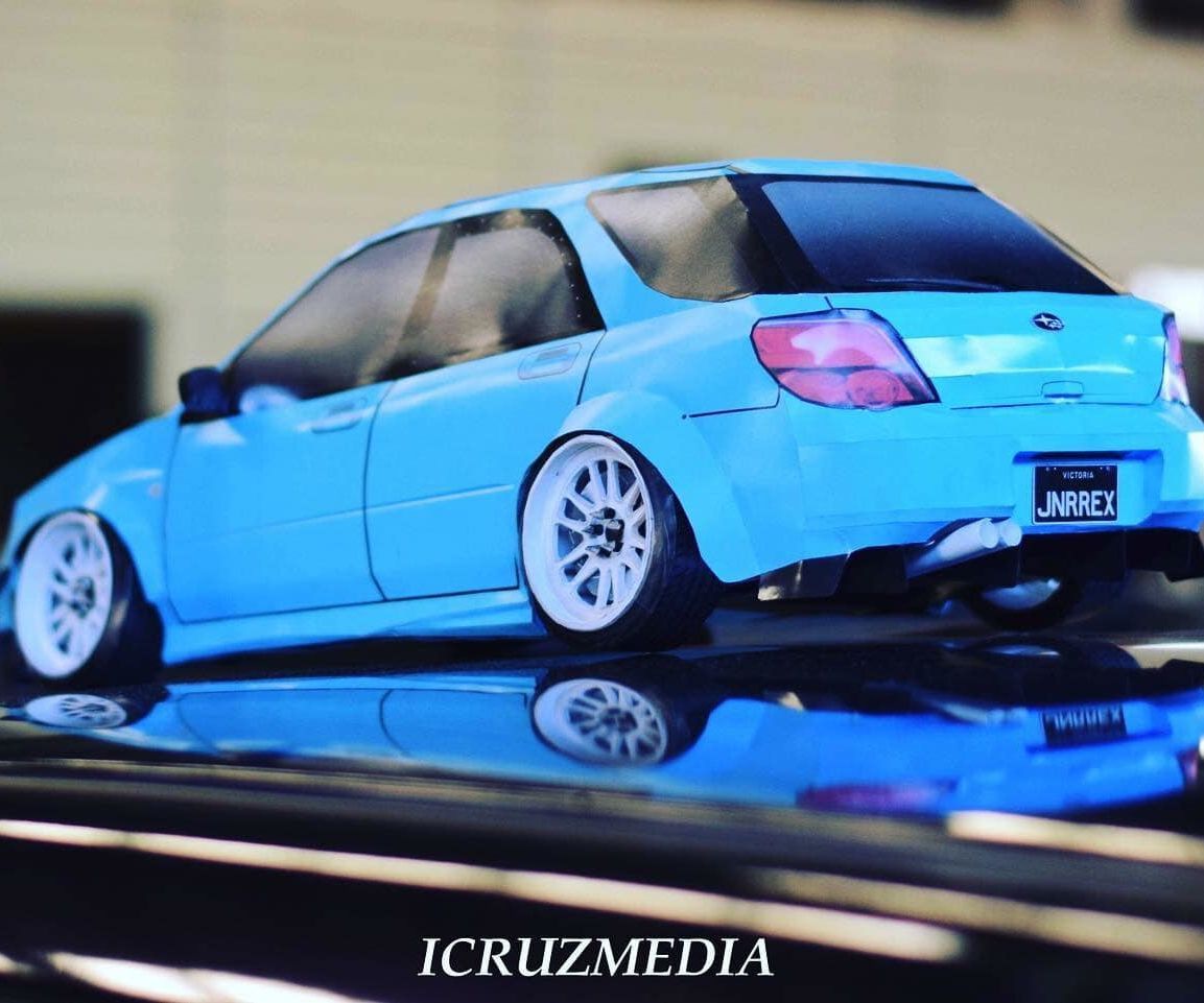

Step 10: Final Result
Ok. I could have done a better job but here it is the finished result! about 60 cm long and 20 cm high. Very big model haha. Apart from that I just added some clear spray to clear things up (no puns intended) and making it waterproof and much more durable. The car has been sent out and will arrive soon!! Anyways hope you guys enjoy reading the about the build and hopefully I have inspire you guys enough to try this hobby!!! Please if you enjoy my work follow me on Instagram @Hacaosuka_Designs and my Facebook page Hacaosuka Design. Also If you have enjoyed the whole process please vote for me as the prizes will help me with my future work! This is Thomas and PEACE OUT!!! C;
