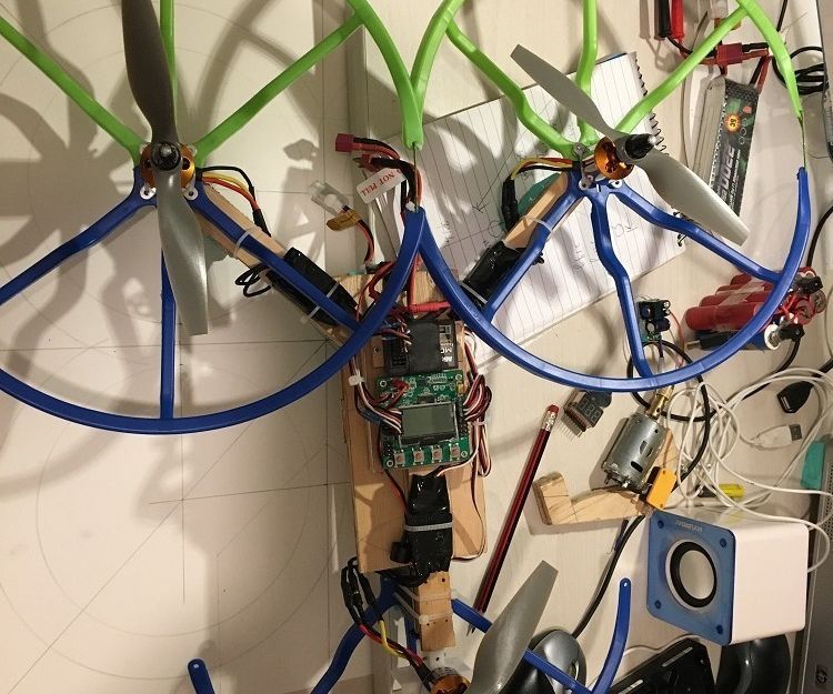

Actually the ALDI foam glider doesn't constitute the framework of this copter, the only frame is made by several pieces of plywood, the motors and ESC are moved from the quadcopter. Firstly I cut the head from the leading edge of the main wing, shortened the main wing to leave room for the fight controller in the middle, joint two stabs together, and mount only one head in the front.
The foam can be easily stick to wood by using heat glue gun, but it rather difficult to remove or change after glued , so think twice before try. I added two small rubber tyres to make it look alike and pretended it can runway takeoff (actually it can).

The L/R front rotor is straight forward, but the tail rotor is a little bit complex because the rotor needs to move left and right by a servo. I used a motor bracket which has two slots, one is 5mm width and other is 10mm, I put a 5mm rod in the slot and mount the rod in wooden frame tail, the servo disk also has a 5mm crank shaft mounted and inserted into the slot, and mount the servo underside to complete the tail rotor movement.

I used KK 2.1.X, there is nothing to change when using the default tricopter setup, at first I was worried the tail rotor will be corrected to move left right, because I used crank shaft which indirectly coupled the servo movement,
The KK told to use right turn prop in tail rotor, but I have no problem to use left turn prop, of course need to change motor turn direction.
The major concern in this copter is no protective measure on the front rotors, of course most drones hadn't, but to play safe, my next instructable will protect all rotors.
