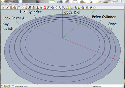

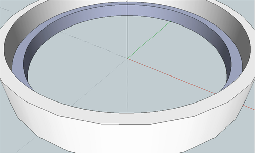

The first step is to determine what size we want to make our prize container. For this, we decided a toilet paper roll would be a good size. We estimated it to be about 2”. (It is actually about 1-5/8”.) So, to make an easy starting point, we chose a diameter of 50mm.
To make sure all of the parts fit together, we drew all of the part diameters as a 2D cross-section (see picture). For gaps between parts, we arbitrarily chose 0.5mm. During dry fitting, we had to sand our parts a lot to make them fit. If I am printing this again, I would increase the gap size to 1mm total. These rings were all drawn using the Circle Tool in SketchUp. Here is a list of the dimensions that we used in this design.
  • Inside of the prize cylinder; the open space: radius of 25mm, 100s
  • Wall thickness of the prize cylinder: radius of 28mm, 100s
  • Gap between prize cylinder and Dial Cylinder: radius of 28.25mm, 100s
  • Wall thickness of the Dial Cylinder: radius of 31.25mm, 100s
  • Gap between Dial Cylinder and Code Dials: radius of 31.5mm, 100s
  • Depth of the Key Notch of the Code Dial: radius of 34.5mm, 100s
  • Thickness of the Code Dial: radius of 37.5mm, 27s
SketchUp Tip: After drawing an object, you can type in the size you’d like (25mm). When drawing a circle, you can also set how many sides it should use for making the circle. For circles, I use “100s” (100 sides). For the Code Dial, I used “27s” for 26 characters and a blank letter. You can see all of these rings in the following screen capture. Note the “27s” in the lower right corner. This is where the dimensions are typed in for changing an objects size.
This group of rings will be the starting point for each of our parts. So, save this and don’t modify it. I saved it as “Cryptex Start.skp”. “.SKP” is the native file type for SketchUp. We’ll keep it in this format for now, as we don’t need to have the .STL file types until we are ready to print.
We now know the diameters that we will be using. But, how do we determine the height for everything? For this, we first have to determine the best text size that will fit in the space we provided on the Code Dial. So, let’s start with designing the Code Dial.

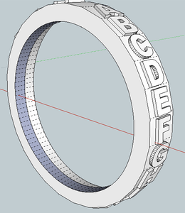

Step 3: DESIGN - the Code Dial
Before beginning, make a copy of the “Cryptex Start.skp” file and name it to “Cryptex Code Dial.skp” or an equivalent. This will be the file that we are editing in this step.

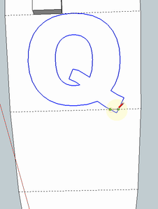

To determine the width of the letters that will be used on the Code Dial, we first measure the length of one of the 27 sides with the Tape Measure Tool. This measured approximately 8.7mm. This distance will be the maximum height of each letter. To allow a little space between the characters, we chose 8mm letters.
Since the letter “W” is most likely the widest letter, we place a letter in an unused area of the screen. In SketchUp, select “3D Text” in the Tools Menu from the Menu Bar. Create the letter “W” with an 8mm size and place it on the screen. Using the Tape Measure Tool, measure the widest point of the letter (~11.2mm). Based on this, we have chosen our Code Dial widths to be 12mm, slightly wider than the letter “W”.
Using the Push/Pull Tool, select the surface between the outer two rings and pull the surface to a distance of 12mm. (Remember, you can pull it to any height and then type in “12” to set the height to 12mm.) This is the width of the Code Dial.
Using the Push/Pull Tool, select the surface between this and the next inner ring and pull it to a width of 5mm. This is the locking piece of the dial. When we assemble the Cryptex, we will use a saw or razor blade and notch out a portion of this under the desired letter. This key notch will allow the locking post of the Prize Cylinder to pull through.
At this point, you’ve probably already noticed that I made the dial with 27 sides for the letters. Why make sides instead of make it round? The simple truth is that in SketchUp, it is a lot easier to affix letters to a flat surface than to a round surface.

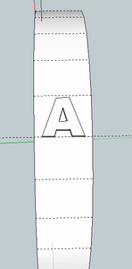

Let’s start adding the letters. Using the Rotate tool, rotate the Code Dial 90 degrees to stand on edge. (I did mine with the locking ring on the left.) Using the 3D Text tool as before, create an “A” and place it on one of the segments. While placing it, I moved the letters until they snapped to the lower left intersection of the segment. After placing the letter, use the Orbit Tool to look at it from the side to make sure the letter was placed flat on the surface and isn’t lifting off on one end. If not flat, re-do this step and when placing in the lower left, move the mouse up and down; you may see a slight rocking in the letter while it snaps to the surface. Place the letter when it has rocked forward and it will be snapped to the surface.
SketchUp Tip: To aid in finding intersections, select “Hidden Geometry” from the View Menu. This will show lines that are used in dimensioning, but weren’t actually drawn in development.
Next, center the letter from left to right. After placing the letter, it was not always fully to the left edge. First, move it so that it is fully to the left by using the Move Tool. Then, using the Tape Measure Tool, measure from the right most point of the letter to the right edge. Take this value and divide it by 2. Move the letter to the right by this distance and it will now be centered.
With the letter placed on the surface, we now need to raise the letter to make it visible once printed. To do this, we need to break the letter down to its line segments. Select the letter and right click on it. In this menu, select “Explode”. If you click on the surface of the letter, you’ll see the surface that can be pulled with the Push/Pull tool. If the center of the “A” is also highlighted, then drawing a short line on the existing lines that make up the center part will likely separate the two surfaces. If at first it doesn’t, continue this process drawing lines over existing lines until it does. Now, with the Push/Pull tool, Pull the character until it is raised 1mm off of the surface.
NOTE: In our first design, we had the letters raised 3mm. While printing this part on its side, the letters begin printing their raised edge over air. As such, the printed filament was loose and did not print a clean edge for this side. At 1mm, the filament is closer to the body of the dial and prints cleanly.
Continue rotating the dial and adding letters until all 26 letters have been placed. After a few letters, adding letters won’t orient in the correct direction. When this happens use the rotate tool and rotate the dial up 90 degrees. Now they should orient correctly as before.
NOTE: The leg of the letter “Q” makes the letter taller than the segment. To fix this, we placed the letter with the circle part at the top of the segment and exploded the letter. We then drew a line where it intersected with the hidden geometry line and deleted the parts of the leg that overhung into the next segment.
Save the file as .SKP.
Before Exporting as STL, rotate this so the left edge lays flat. This is the orientation that it will be printed. Now, Export the file by selecting “Export STL…” from the File Menu. In the popup menu, select the units to be Millimeters. I left the file format as Binary.
This part is now ready to take to the printer.

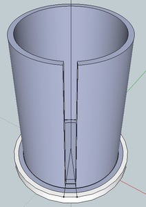

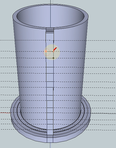

Step 4: DESIGN - the Dial Cylinder

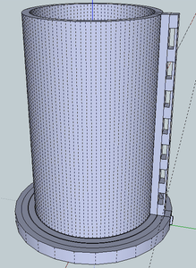

OK, Now we’ve got the hang of how to use SketchUp. We should be able to design the next pieces a little quicker.

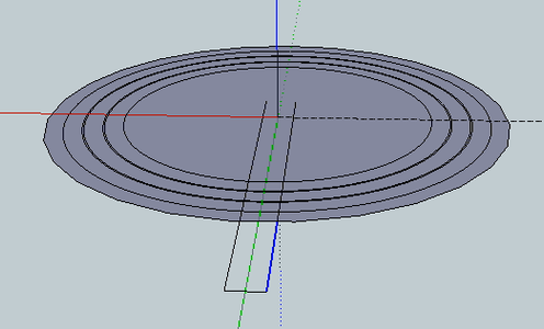

First, make a copy of the “Cryptex Start.skp” file and name it to “Cryptex Dial Cylinder.skp” or an equivalent. This will be the file that we use for editing in this step.
The Dial Cylinder will need to have an end plate at one end to keep the dials on. For this, Pull all of the surfaces up a desired thickness. For ours, we chose 6mm. You may want to go a little thicker, just so that when you are separating the two halves of the Cryptex, it is easier to grab on to.
Now that we have the end plate ready, we need to create the cylinder. This is the cylinder that holds the Code Dials. It also allows the lock posts of the Prize Cylinder to pass through for locking with the Code Dials. To create this gap for the posts, I used the Tape Measure Tool and measured in 0.5mm from a segment corner. When doing this, a guide is placed for later use. I then do the same on the opposite side of the segment. From these guide point, draw lines to the center. When I create the cylinder this portion will not be pulled, thus creating the desired gap. Having an angled gap shouldn’t be a problem for our design.
NOTE: My first attempt was to raise the cylinder, draw lines along the length and then push the gap through the cylinder wall. Because the cylinder was a circular surface and not linear, SketchUp did not allow the Push/Pull tool to be used. For another method for creating this gap, see how I created the locking posts on the Prize Cylinder.
Next, we need to determine the height that we want to pull the cylinder up to. With 7 rings at 12mm, we’d have a distance of 84mm. We will also be adding a keeper ring to hold the dials in place, so I added 2mm for it to be secured to, plus an additional 0.5mm of gap. That brought me to a cylinder height of 86.5mm.
Now, Pull the appropriate ring for the Dial Cylinder to 86.5mm.

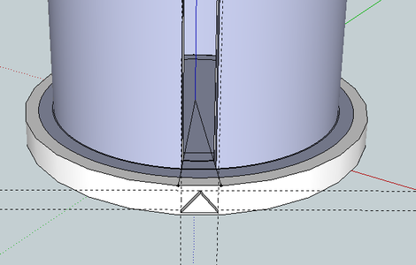

When assembled, the gap won’t be seen by the operator, so we need to draw an indicator so that they know where to align the combination. We’ll add an Arrow indicator for this. To do this, I used the Tape Measure tool and measured in from each edge of the appropriate segment 1mm. Then, draw a line from each of the lower corners to the midpoint of the top line and then a line between the lower corners. This creates a triangle. Pull the triangle out 1mm.
SKETCHUP TIP: Using the Tape Measure Tool to create guide points from a line generally creates a guide line. Measuring from a point creates a guide point.
This cylinder is now complete.
Now, Export the .STL and this part is now ready to take to the printer.

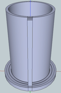

Step 6: DESIGN - the Prize Cylinder
Before we begin this step, we need to know how wide the lock posts can be. First, open the Dial Cylinder file and measure between the two nearest points of the gap in the cylinder. This is about 5.8mm. So, we will need our locking posts to have a width smaller than this. We’ll use 5mm.
As before, make a copy of the “Cryptex Start.skp” file and name it to “Cryptex Prize Cylinder.skp” or an equivalent. This will be the file that we are editing in this step.
As stated during designing the Dial Cylinder, you can’t use the Push/Pull Tool on a circle edge. So, instead of trying to do the triangular gap method as before, I decided to make straight lines to work from. To do this, I made a box on the same plane as my Cryptex starting point. First, I should point out that I found a segment that was perpendicular to an axis guide and was actually cut in half by one of the axis guides. In my case, it was the green axis. So, I rotated my image to work on this edge. I made the box so that it is parallel to the green axis.
Now that I have lines parallel to the green axis, I can move them in toward the center to create a 5mm band that reaches from the center to the outer surface. Measure the distance from the center point out to one of the parallel lines, measuring along the red axis. Subtract 2.5mm (1/2 of 5mm) and move the line in toward the center this distance. Do the same for the other line.
NOTE: This same technique could have been used for creating the Dial Cylinder, but making a 6mm width for allowing enough gap for the locking posts.
The Prize Cylinder will need to have an end plate at one end. For this, Pull all of the surfaces up a desired thickness. For ours, we chose 6mm. You may want to go a little thicker, just so that when you are separating the two halves, it is easier to grab on to.

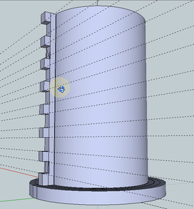

Now we need to create the cylinder. We had a Dial Cylinder distance of 86.5mm, plus a Keeper Ring distance of 4mm, giving us a total distance of 90.5mm. Subtracting 0.5mm for a gap, we chose to make it 90mm. Pull the Prize Cylinder ring to 90mm. Also, raise the lock post section to this height.
Next, we need to notch out our pins. To do this, use the Tape Measure tool and draw guide lines.
The guide lines are at the following distances from the TOP.
  • 1st Post start point: 0mm
  • 1st Post end point: 5mm
  • 1st Gap end point: 13mm
  • 2nd Post end point: 18mm
  • 2nd Gap end point: 25mm
  • 3rd Post end point: 30mm
  • 3rd Gap end point: 37mm
  • 4th Post end point: 42mm
  • 4th Gap end point: 49mm
  • 5th Post end point: 54mm
  • 5th Gap end point: 61mm
  • 6th Post end point: 66mm
  • 6th Gap end point: 73mm
  • 7th Post end point: 78mm
  • 7th Gap end point: 84mm
  • Keeper Ring to base: 90mm
This gives 5mm Posts and 7mm Gaps. With the Code Dial having a width of 12mm with an inner ring width of 5mm, why didn’t I just use distances of 7mm for posts and 5mm for gaps? Well, that would be too tight. How about 6mm posts and 6mm gaps, that would give 1mm gap around the Code Dial? That probably would have worked, but I didn’t want things so tight that you could feel the posts on the dials as you rotated them. So, I chose 5mm Posts and 7mm gaps. Also, I added 1mm to the first gap so that everything is offset, keeping the posts from rubbing on the next Code Dial’s key notch.
Now that all of the guidelines have been placed, draw a line where the guidelines intersect with the surface. This will create several surfaces that we can now remove to create our lock posts.
Push every other surface in past the outer “Gap” ring, creating the posts that will lock with the Code Dials.
Draw the Combination Indicator Arrow as was done previously for the Dial Cylinder.
At this point, the product has been designed. However, to print this part, we need to support the posts, since they are unsupported while printing. To do this, I drew lines 1mm from the outer surface and pulled it from post to post. 3D Printers can easily bridge small gaps while printing. This will easily be trimmed away after printing.
NOTE: 3D Printing software does have settings to create supports, but I decided to design my own in and not trust that I get the printer settings correct every time.
The Prize Cylinder is now complete.

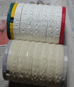

DRY FIT:
We printed all parts to make one Cryptex, plus one spare Code Dial to use in molding without a key notch already in place.
When sanding parts, I would recommend wearing masks and working in a well ventilated area.
Before we can mold our pieces, we want to make sure that everything fits correctly. We sand any areas that are too tight. We notch seven of the code wheels with a razor blade and dry assemble the Cryptex. Everything now fits as expected.
At this point, if you aren’t going to mold the Cryptex, you can assemble it and glue on the Keeper Ring. Acetone can also be used for fastening the Keeper Ring. The Cryptex is now complete.
NOTE: There is a setting within the Slic3r configuration that I had not set before printing. The software allows for randomizing its start position. Since this was not set, each printed layer started at the same position. This resulted in a slight raised rib along the Dial Cylinder and the Prize Cylinder and required extra sanding. Next time, I’ll randomize my start position.
DONE!

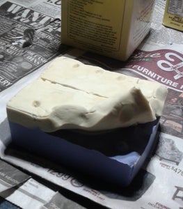

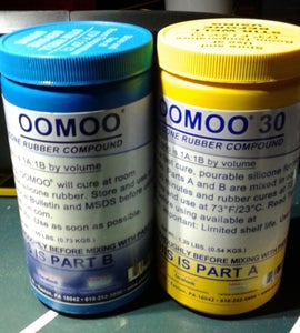

Step 8: MOLDING
Our problem not just with the cryptex, but with our other 3D printing projects as well, is that much of what we design is not intended to be a “one off”. So we knew we had to be able to home replicate our results without long print times. We decided to create molds of our parts and to accelerate the learning process, so we bought a molding starter kit to help learn about making silicone molds. The one we bought is a “pour on” kit from Smoothon, which has everything needed to get started with molding. Silicone molds are designed to hold up to many pours so we should be able to save our original 3D prints for future mold making and build a finished product from the molds. This will allow us to make as many Cryptex gifts as needed from our original print, freeing up printer time for an ever growing list of projects.
Materials:
  • Molding starter kit or other molding supplies
  • Cups
  • Mold boxes. I used milk cartons
  • Stir sticks
  • 5 minute epoxy
  • Box knife
  • Exacto knife
  • Clay
  • Tape
  • Rubber bands
  • PPE (Eyeware, gloves, masks)
While sanding and creating molds, do so in a well ventilated area and use proper PPE.
Please reference the pictures for the materials and tools that we used.
After doing all of our sanding and dry fitting, each part is sanded and sealed with “super seal”. It is then sprayed with mold release once placed in the molding box.

I first begin with a mold that is large enough to allow at least a ½” of material to completely surround the object. I cut down a milk carton to the size needed for this mold.
I then built a clay bed to hold one side of the Code Dial. The clay will allow me to build a two part mold to let the lettering release better from the mold and to give the uniform thickness needed for these objects. I placed about a half inch of nonsulphurous clay into the bottom and laid the ring on top of it and pressed down uniformly until it was imbedded about a 1/8”.
The wider side of the ring that rides in the channel needs to be in the clay to allow for easier release from the mold when completed (see picture for placement). I then put dents into the clay to make alignment keys in the mold. Alignment keys hold the mold halves together when completed. Last thing to do before the pour is to spray the entire mold, clay and object with mold release.
Note the line drawn on the side of the mold. That is to indicate a height of at least ½” above the ring needed for a durable mold.
Next, take the silicone rubber and mix equal parts of A & B, making sure to completely combine the two parts or the mold will not set up. It is also a good idea to work somewhere around 70 degrees Fahrenheit for a proper cure. (The Silicone we used says to use at 73 degrees F to be more precise.) Mix only as much as you need for the mold as silicone is expensive. This entire project took around $100 in silicone alone.
We do not have a vacuum chamber to remove the air bubbles from our mix so we used a high thin stream poured over several minutes. While pouring, it is best to pour in a corner or the center away from the object.
Allow this to set up for a minimum of 6 hours.
Once it is cured it is time to remove it from the mold box. To do so, remove the silicone and the clay from the mold box together. Separate the two halves leaving the master copy of the Code Dial imbedded in the silicone and remove all of the clay. It is now time to put it back into the mold box and get ready for the second pour.

All parts poured easily and without air pockets except for the lettered rings. I needed to give the mold several gentle squeezes near the end of the pour to work out the remaining air bubbles. I believe this can be fixed by building in better and bigger air releases than I did. I will make another mold one day to speed up the process as each Cryptex needs seven Code Dials for our design and each takes 20 minutes minimum to set up. Two molds would speed up this process greatly.
To get different colors, mix dye into Part A before combining with Part B.
The picture shows the master (White) which was 3D printed and the molded copy (Red, Green, Yellow, and White) described here.

UPDATE: Fixed the Keeper Ring to hide the lock posts.
