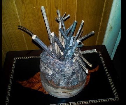

Using a handsaw, I cut into the log ends to make a stop cut. This way my gouges would not cut into the rim I was creating. I shaped the entire exterior once the inside was complete. I then used a random orbital sander to remove the sharp edges while maintaining the nice shallow gouge marks.
Step 4: Finishing
I used mineral oil...the kind you can find at a supermarket or corner drug store, to finish the bowl. It is a food safe oil. The bowl was then done and ready for use.
