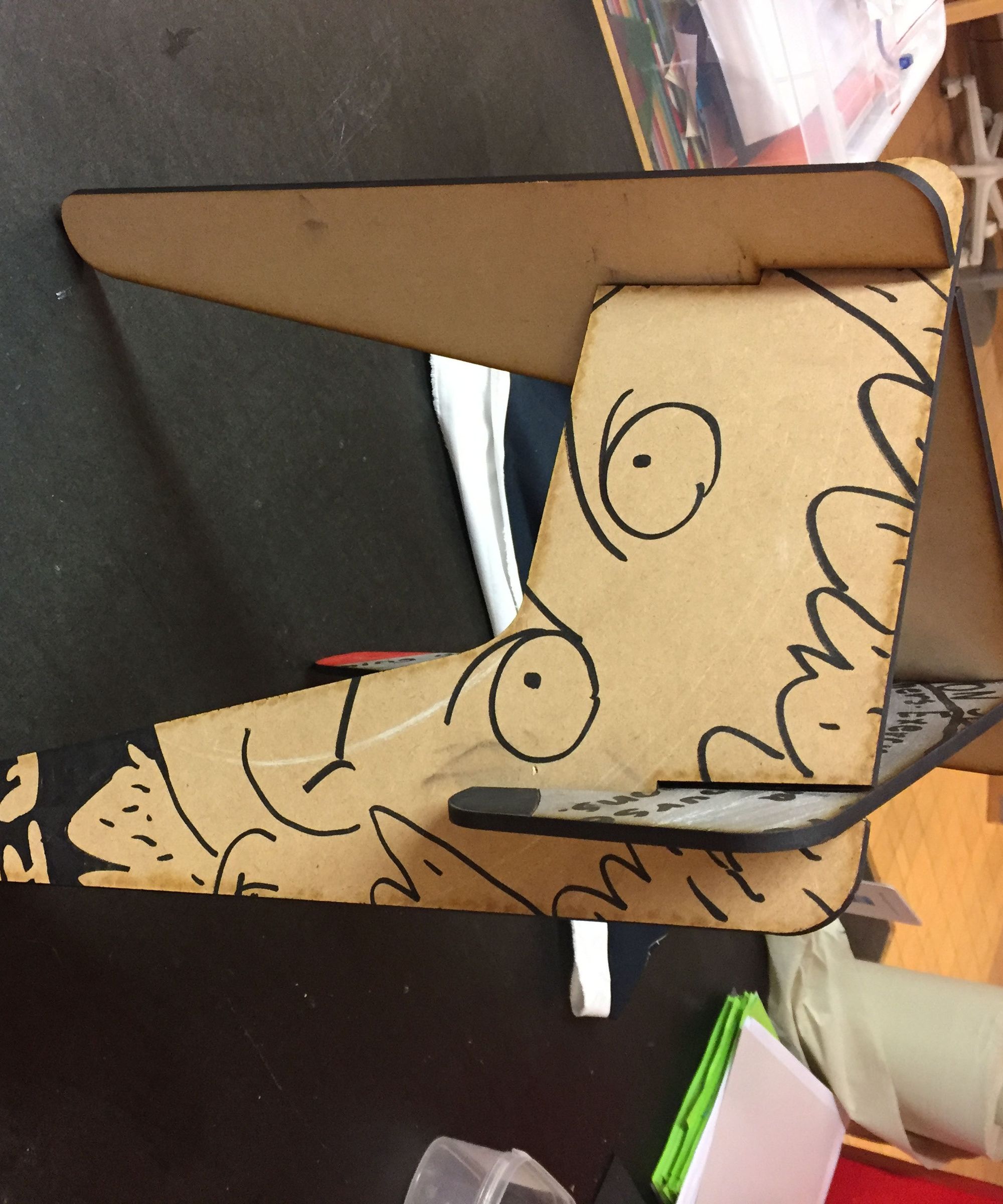

We used the webpage http://www.makercase.com/ to maker houses in different sizes based on how big pieces of scrap material we had. We then opened the generated files in Illustrator and added windows a bit randomly and unevenly to get a bit of a favela look.
When we had a few different ones we started to cut them out on the maker spaces laser cutter. The pieces where then glued together with woodglue but leaving one side open so we later on could fit the lights inside them.
