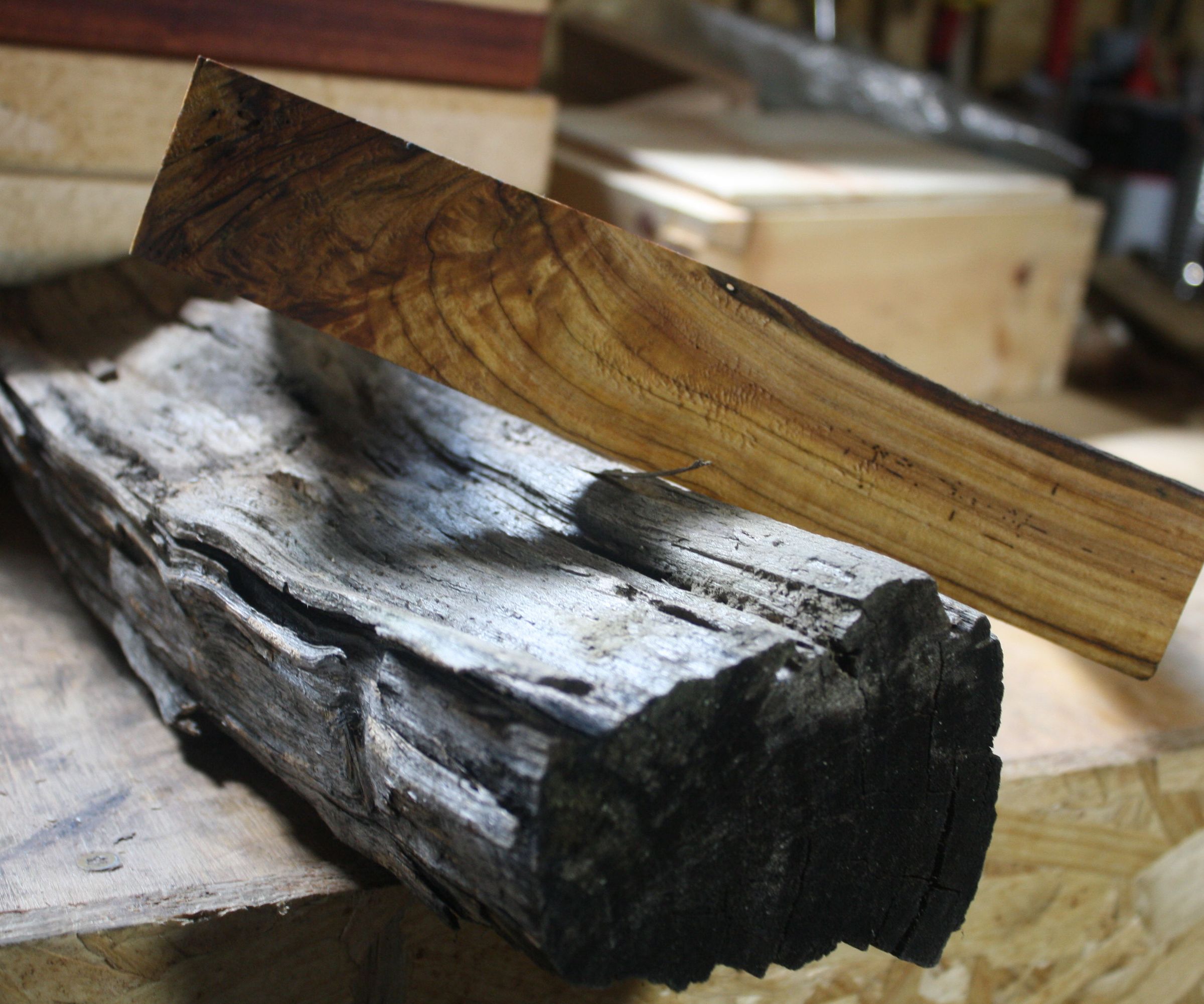

I happen to have a few scraps of wood from a project I just finished up. Any wood will work fine but for a small project like this, it's fun to use something exotic. The local woodworking store sells off-cuts at $3 USD per pound, it's a great way to experiment with different kinds of wood.
Once you've selected your pieces, glue and clamp them together. Make sure that one large face is relatively flat. It doesn't have to be square to any of the sides, but it does need to be flat. After the glue dries, take a piece of sandpaper; set it down on a flat surface abrasive side up, set your work piece down and sand away. Just make sure to keep even pressure.
