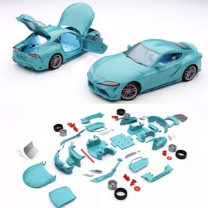

Get the STL files from: https://www.myminifactory.com/stories/toyota-gr-supra-full-3d-printed-model-1-10-61ae138bf0775
Components
3D Printed Parts
- 3D-Printed Car Body – Designed or downloaded from a 3D model repository (https://www.myminifactory.com/stories/toyota-gr-supra-full-3d-printed-model-1-10-61ae138bf0775).
- Axles – Compatible with your car body design.
- Doors
- Roof
- Fenders
- Chassis
- front and rare bumper
- Wheels and tires
- Mirrors

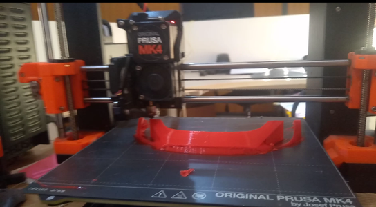

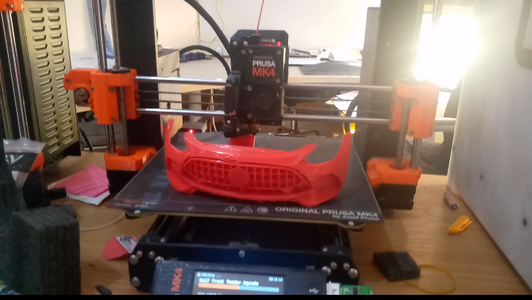

Step 1: Print the Model
3D Printing the Car Body and Parts
- Prepare the 3D Model:
- Slice the STSL files of all the components.
- Ensure the to use stable position for the slicing into G-codes
- Set Up the 3D Printer:
- Use PLA or ABS filament for durability. (except for the font, rare bumper and the tires)
- Use 3D filaments such as TPU to print the Tires, mirrors, front and rare bumper,
- Adjust print settings:
- Layer height: 0.2mm (or finer for smoother details).
- Infill: 20-50% for strength.
- Use 100% infills for parts like the bumpers and rims
- Supports: Enable for overhanging parts.
- Print the Parts:
- Print the sliced car body parts and chassis,
- Post-Processing:
- Remove supports and sand rough edges for a clean finish.

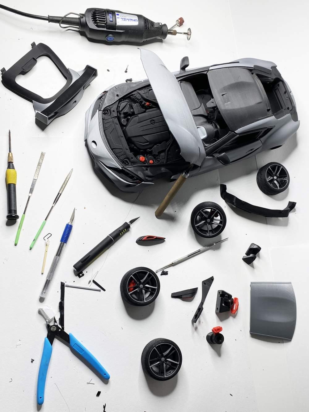

Step 2: Fabrication and Modification of Parts
- Inspect and Prepare:
- Check all printed parts for accuracy and fit.
- Trim any excess material using a hobby knife or cutter.
- Drill Holes:
- Drill additional holes for screws, axles, and wires if needed.
- Melt some part in hoof to accommodate your fabricated steering mechanism
- Strengthen Parts:
- Use plastic sheets or acrylic to reinforce weak areas.
- Paint (Optional):
- Apply spray paint or acrylic paint for a professional finish.
