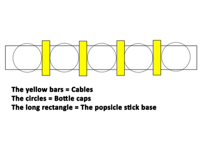

Step 1: Inspiration and Early Sketches

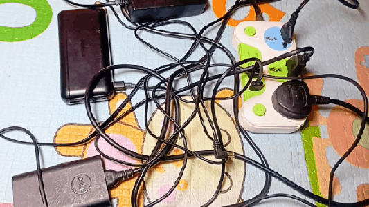

Like many people, I was constantly frustrated by tangled cables slipping down to the floor and piling up near the wall outlet. Not only was this messy, it made cables harder to reach and even caused wear and tear over time.
Of course, cable organizers already exist, but I wanted to create my own DIY version using only simple, easily available materials. I began by brainstorming different layouts that could hold multiple cables neatly while also preventing them from falling off when not in use. To visualize the idea, I sketched several designs on the computer.
The first design featured a base plate with evenly spaced circular discs attached to it. The gaps between discs were wide enough to allow most cable sizes to pass through easily, but at the nearest points between two adjacent discs, the larger cable head (USB, HDMI, charging tip, etc.) would be stopped from falling through.

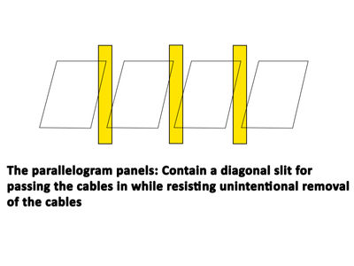

I also added a retention slot system: each consisting of two parallelogram-shaped plates placed close together, forming a diagonal slit in between them. This slit was just wide enough for the cable to pass through, but due to its diagonal orientation as opposed to the vertical orientation of the cable inside, it prevents the cable from slipping back out on its own. With this, the organizer could securely hold cables in place while still making them easy to insert or remove when needed.
