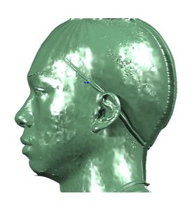

To project these curves on the back of the head in 3D, select the Curves-tool (Insert>Curves>Project). Select the sketch and the full surface of the head as surface.

Start a 3D-sketch and use Spline to trace the curves you’ve projected on the head.
Create a profile for the 3D sketch.
Step 10: 3D Model of the Headset That Actually Fits
Use the Swept Boss/Base tool (Insert>Boss/Base>Sweep) to make a sweep with the latest sketch as profile and the traced 3D sketch as path.
