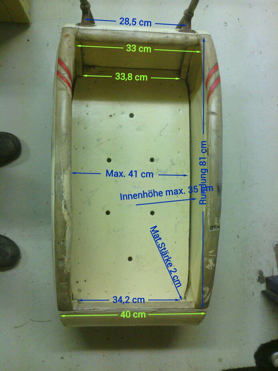

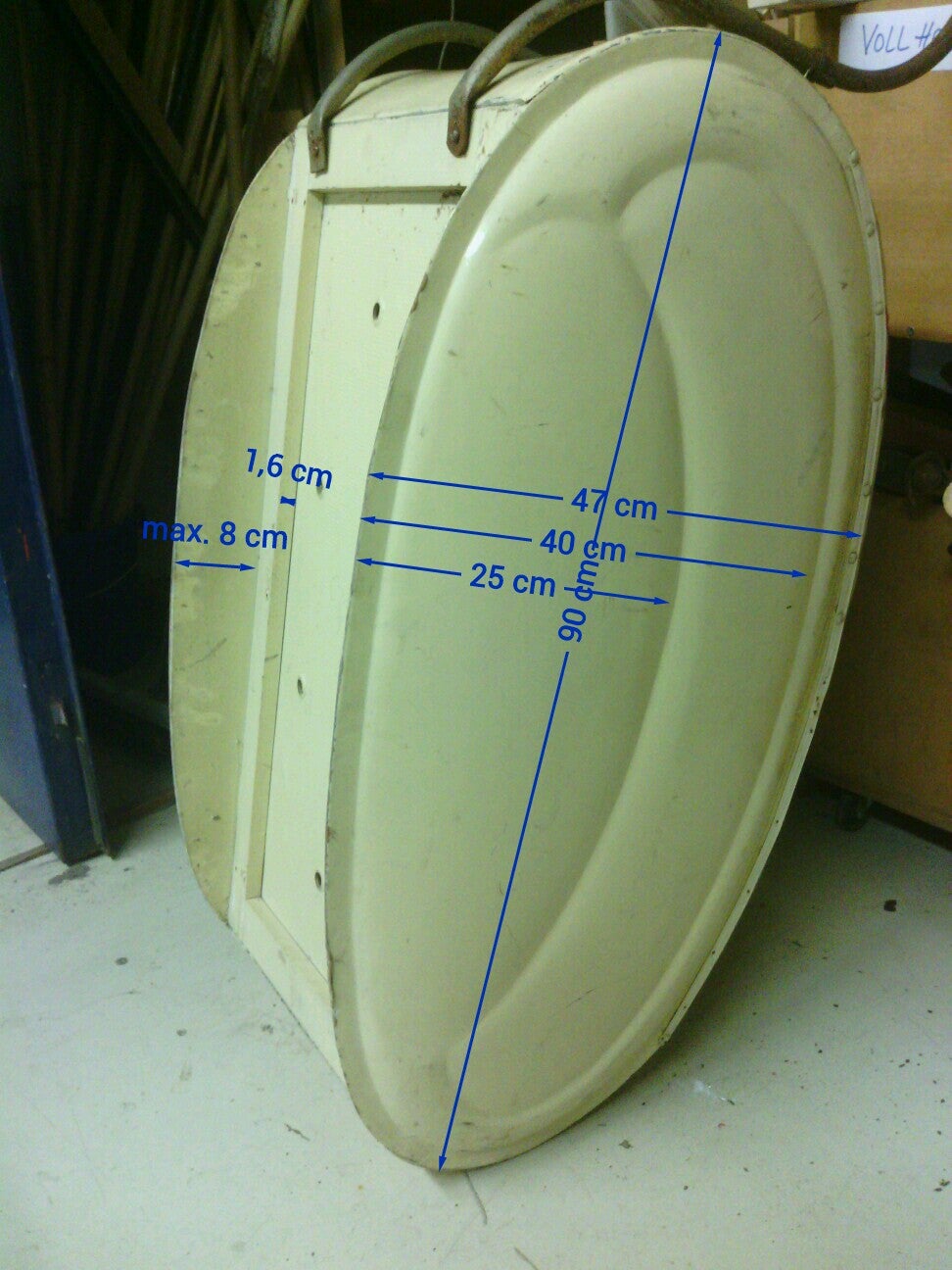

There was I with the leftovers of the pram. First I did some measuring. I very quickly decided to get an old kids trailer for the chassis. I found one close by for 30 €.
Back in the shop I almost couldn't believe that the lenght of the trailer was a perfect fit for my project. With the excess width I dealt later.
The side parts from the softtop of the old trailer should go in to a angled position to give a nice silhouette.
The original floor panel had to come off. I wanted a curved underbody. Like this it also should be possible to lower the seating position as much as possible to get the center of gravity down.

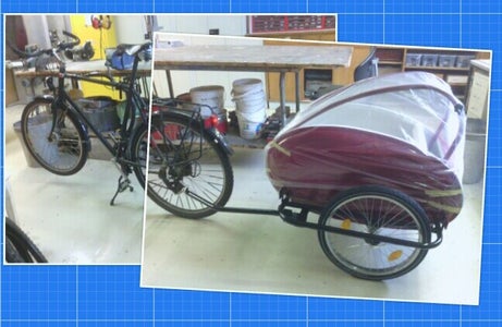

Step 10: Maiden Voyage
Today was the first sunny day this week and so I took the kid on a short trip to the playground in his new trailer. He really seemed to like his new ride!
And the trailer created quite a buzz on the playground... :-)

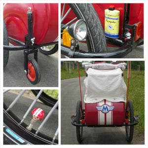

Step 12: One Year After....
It took a while, but now I finally have a matching bicycle for the trailer...
The trailer itself got a few updates:
  • white rally stripes to match bike and helmet
  • rims painted in same colour scheme as the bike rims
  • playmobile valve caps
  • trolley wheel
  • lights: red LEDs, battery and switch built into a vintage repairkit tinbox
