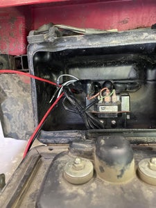

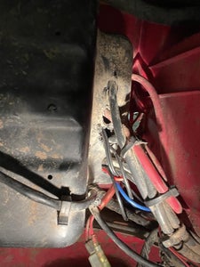

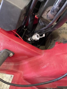

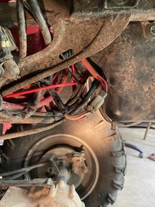

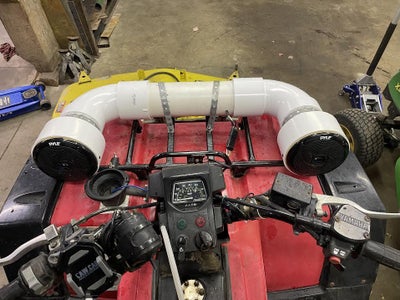

Step 1: Power Wiring

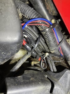

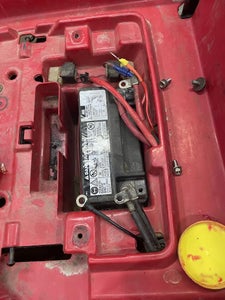

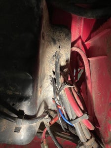

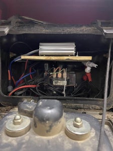

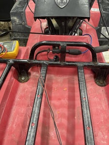

Yamaha has a front auxiliary outlet on the front rack,(see middle picture) so I chose to run my remote wire for the amp to the back tool box; running it down the frame with the existing wires. I pulled power and powered ground off of the battery with soldered on ends, (see first picture) into the tool box. which I had to drill a hole to get the wires in.

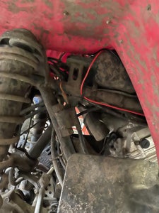

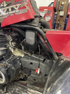

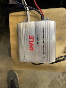

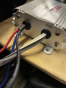

Step 2: Amp Wiring
The amp that I purchased had leads for the speaker output; using the wire that came with the speakers I soldered them together and heat shrank them, then ran them to the front with the remote wire. I put the volume control and the aux input on the handle bars running the wires for them with the remote wire; the cables were short so I needed extenders.

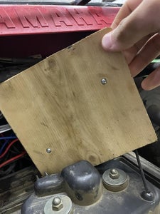

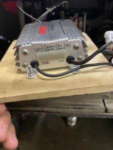

Step 3: Amp Mount

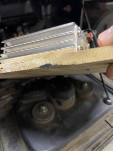

I had a cedar shim left over from a previous project so I used a utility knife to cut the thicker end to 4.5"x4.5". I marked out two adjacent holes and drilled it through for small screws with nuts, I tightened them down untill the screw head was recessed into the wood.

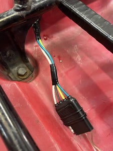

Step 4: Speaker Wiring

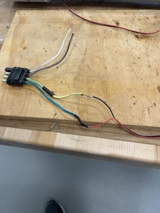

I wanted the system to be easily removable from the bike, so I used a 4 wire trailer connector soldered onto each end of the wires.

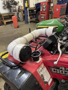

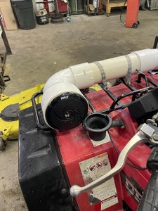

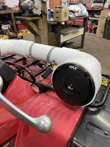

Step 5: Pvc

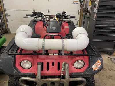

For the main body of the system I used 15in of 4in schedule 40 pvc. that went into 4in couplers to a street 90. For the cone that holds the speakers I got 4-6 reducer hub.

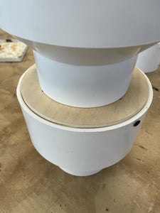

Step 6: Speaker Mount

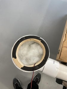

In the 6in pvc end I cut out 3/4 plywood to fit inside of the hub. Using a jig saw I cut out a 4.5in hole using the ends of the reducer hub. Using a rasp I cut out a grove for where the wires attach to the speakers, along with routering a 45 degree onto the speaker end. To attach them to the 6in hub I used 1in long screws that I pre drilled.

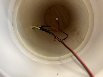

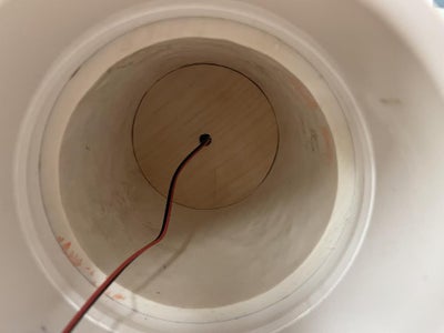

Step 7: Inside the Pipe
With a speaker setup like this you want something to separate the two speakers, so that the pressure of them don't fight each other under heavy load. I cut out a 4in insert for the pipe and drilled a small hole through it for the wire. I made sure that the hole I drilled in the face of the pipe was just big enough for the trailer connector wires to fit through, ensuring a good seal.
Step 8: Finishing Touches
The speakers I purchased came with foam water seals that I put on and got toy stuffing that I filled the pipe with to help push the sound out. Then I went through and taped up where the extenders hooked up to help with water.
