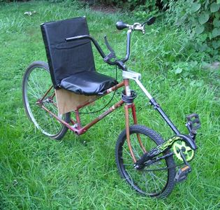

Step 5: Install the Front-Wheel Drive
Mount the fork of the frameset onto the axle of the drive wheel. It may be easier to fit the fork dropouts between the rear dropouts.
Insert a seat post into the front seat tube. Attach the top of the seat post to the stem of the frameset. I used two strips of sheet metal. Depending on the stem you use, you may wish to turn the stem around to avoid interfering with the attachment to the seat post.
You may change the height of the pedals by adjusting the insertion of the seat post.
Step 6: Add Handlebars and Seat
The two most crucial remaining parts are the handlebars and the seat.
Although it is possible to steer such a bicycle without handlebars, handlebars are helpful. However, most styles of handlebars would interfere with pedaling. Therefore, you must use either BMX or ape hanger handlebars. The other possibility is to fashion a tall stem, but that may require special hardware, such as a long stem bolt.

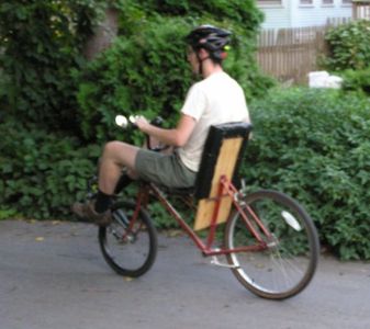

The seat is very important for both comfort and stability. A bad seat is almost as bad as no seat. I made a seat from plywood, then upholstered it with packing foam and vinyl. The plywood has a nice springiness to it. You may need to experiment with various seat designs before finding one that works best.

Step 8: Ride the FWD/CS/SR Bicycle
The hardest part is actually riding this contraption. It is very different from a standard bicycle.
- Your back participates in pedaling.
- Standing starts are difficult. (A low gear helps.)
- Pedaling affects steering. With practice you can learn to steer with your feet.
- If you have no shocks, you may wish to slightly underinflate the tires.
- If the seat is not completely stable, you will lose energy and control trying to keep the seat straight.
- Lastly, people will gawk at your bike, as they try to figure out how it works.
