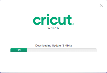

Step 1: Download Cricut Design Space Software
Firstly you'll have to go to Cricuts' website (https://cricut.com/en-us/apps) and download their design space. This features a multitude of pre-made designs in their library as well it is how you'll interact with the Cricut device.

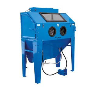

Step 5: Sandblast Your Glass
Once you have the design on the glassware and orientated the way you desire you'll simply head over to the sandblaster and frost the glass. A tip for this is to hold the glass far enough away from the nozzle so as to not rip off the vinyl. It has a strong enough bond to stay on but continual force will cause the edges to come off.
