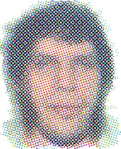

We'll do the halftoning and vectorization in Illustrator.
  • Open up the cyan jpg in Illustrator.
  • Select the image
  • Edit > Edit Colors > Convert to Grayscale

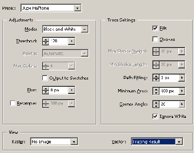

  • Filter > Pixelate > Halftone. I chose a 30 px halftone size.
  • In the Control Panel, click the drop down arrow next to "Live Trace" and select "Tracing Options"
  • I used: Black and White, Threshold 128, 0 px Blur, Fills, 2 px Path Fitting, 100 px Minimum Area (so the tiniest halftone holes are ignored), Corner Angle 20, Ignore White. Save these options, since you'll need them three more times.
  • In the Control Panel select the "Expand" button, which will make paths from the Live Trace.
  • If you want to, clean up extraneous dots with the Direct Selection Tool (white arrow). If you select some dots to remove, and then hit delete, it only deletes the points you selected. If you hit delete again, it removes the entireobjects you are on the boundary of selecting.
  • File > Export. Select "AutoCad Drawing (.DWG)" For this window, my options were: Version 2000/LT2000, 1 inch = 1 unit, 8 colors, PNG raster file format, Preserve Appearance
If you're stuck, here's a similar walkthrough describing halftoning in Illustrator.

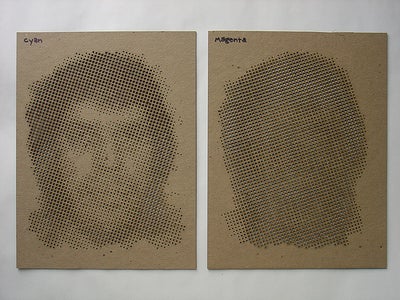

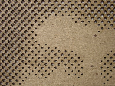

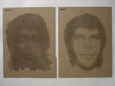

Step 4: Cut

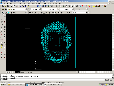

  • Open the .DWG file in Autocad
  • You might have to Select All and hit "Explode" depending on what version of Illustrator and what version of Autocad you're using
  • Select the appropriate line weight and color (in my case, 0" and Cyan)
  • Send to the laser cutter, making sure that the color you've selected corresponds to the proper settings for cutting the material you've chosen.
Repeat the last two steps for the Magenta, Yellow and Black jpgs. The only difference between them will be in the halftoning step: when you halftone, you need to change the angle of Channel 1. For Cyan, 108, Magenta, 162, Yellow, 90, and Black 45; otherwise the four halftones will line up and overlap.
Instead of doing the four colors separately, I did all the Illustrator work in one step so I could make sure they were aligned. I added a rectangle around the perimeter that would help me align them when spraying. Another alternative: try adding four small dots near the corners.

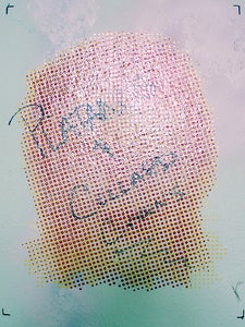

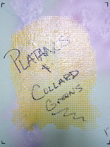

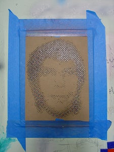

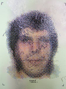

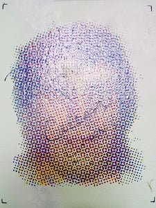

Step 5: Spray It
Select a location where you'd like to share your work/play. In spraying the layers, I started with the densest (Yellow) and worked up to the least dense (Black). This seemed to work well, but I'm sure there are other techniques.
Place your first layer, tape it down, and mark the corners so you can align the following layers. I used lots of tape, but this is my first stencil so I still got some overspray. The can recommends a distance of 6-8 inches, which worked pretty well for me. I used about two quick coats per layer. Between layers I needed about 3 minutes for it to dry.
