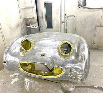

After painting we added the fan and the carburetors and the engine looks great again.
The final step should be that we place the engine back in the car, but right now the car looks like you see on the photo. The Healey seems to smile, so I hope it is happy that it is also getting a full body respray.
We completely stripped the car and when it gets back from the paint shop we will rebuild it and after that we will put the engine back in the engine bay.
