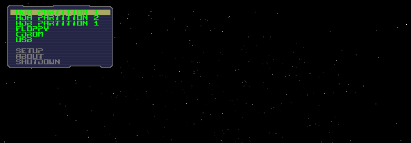

Step 5: 3 Download and Create CD With Plop BooT Manager (Optional)
Note: This step is optional depending on the features of the PC.
Normally to boot lubuntu from the USB pendrive, it is simply required to configure the boot order that is first made from USB devices and plop manager is not required.
In my case the bios of my Compaq computer, does not allow the option of USB boot, in some cases is solved updating the BIOS, but depends mainly on the characteristics of the PC.
Plop Manager allows boot from USB allowing to run our pendrive with lubuntu, only you must download plop manager burn in a CD and configure in the Boot BIOS from CD-ROM.

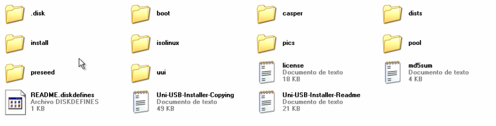

Step 6: 4 Create Live-USB in UUI of Lubuntu in USB Pendrive
USB Memory Stick 4GB Formatted
Run UUI:
  1. Select linux distribution "lubuntu".
  2. Select image iso lubuntu 16.04.3 32-bit LTS.
  3. Select USB Pendrive, it must be formatted
  4. Create live-USB and OS ready
Step 7: Run Plop Boot Manager And/or Boot USB Pendrive
Reboot PC.
