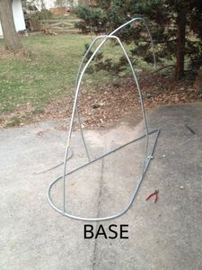

Step 1: Build the Frame Base
To build this frame use out of 1/2 inch conduit pipe, and a few aluminum flat bars. Aluminum is lighter but much more expensive than conduit. To build the frame, use a pipe bender or a foot to bend a half circle 3 feet wide at the center, and then bend each end towards each other but not touching. Then attach separate pieces to the ends using pipe connectors so that the entire base is six feet long. You should have an ice cream cone shaped base for the fairing that is about 3 feet wide at its widest point and 6 feet long.

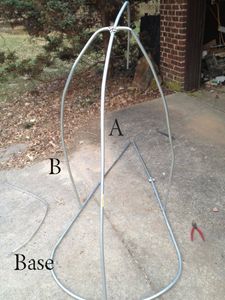

Step 2: Finish the Frame
Next, bend a 10 foot length of conduit so it has a straight back and curves into about a 75 degree angle. This is piece A as shown in the picture.
After that piece is bent, take one more length and bend that into a upside down U shape. This will go in the center and hold up the previously made piece and is piece B. This piece should be about 4 feet tall and curve with about 3 feet between each pole.
Connect these pieces using conduit connectors and small bolts. B should be 1/3 lengthwise down the base, so closer to the front or big part of the ice cream cone, and A should be right down the width-wise center. They should be bolted at the top where they connect.
For added support, repeat with step B and make a smaller version for the end. I used Aluminum flat bar for this, but conduit would also work. make it as tall as it must be to intersect with A.
