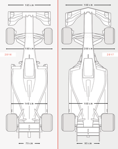

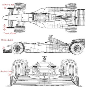

Step 1: Research
First order of business is research, especially dimensions were important. Heigth, width, length... The four pictures were my main focus. I always tweaked dimensions a litte bit to fit my own design.
When taking on this kind of build its important to understand that you are building your own car replica, nobody said you have to follow a set dimension type because every year these F1 cars are different and they have differences in dimensions.
My main guideline was to make the car about 5 meter long, about 1.4 meter wide and about 1.2 meter in heigth.
