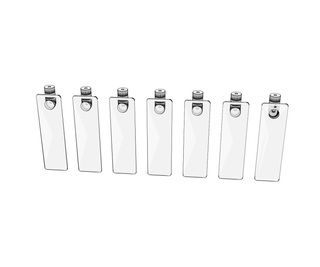

Being a PhD student in pursuit of 'click-to-manufacture' technology in the realm of 3D Printing, I decided it would be cool to demonstrate a simple concept of the potential of Additive Manufacture in this area - whilst keeping it fun!
I designed, printed and assembled a circuit for a fully 3D Printed piano! Whilst I plan to match the tone frequency up with the actual notes in the future, I think the result is still pretty nifty and could potentially lead onto other printed instruments!
I designed this in Fusion 360, which enables you to easily print in multi-material - allowing for conductive and non-conductive filaments to be used together to form a functional object. The stl was then exported to Cura and printed on an Ultimaker 3 - but you can use any printer with multi-material capabilities (and potentially single extrusion with some assembly).

Printing can potentially take some patience and experimentation. Remember, if you have oozing problems the chances are that you will have a short across your sensors - causing significant cross-talk! I've also included the original STLs for convenience - but I encourage you to make your own and let me know how it goes!
