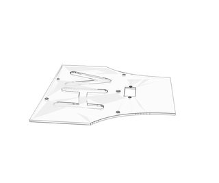

Step 7: Designing the ROBOT
For designing The robot I used Fusion 360 software as it is free to use and Is very user friendly .
Firstly, I made a rough idea about the dimensions and where each part will go.
Then I started modelling its body, The body has A Top closing Lid and a bottom chassis as a main component.
To make The entire modelling easy to understand I also made an animation video in Fusion 360 which shows how the whole robot body is assembled.
I made Li-ion cell holder which is used to hold the batteries to the chassis using M3 bolt and nut.
Also a mounting bracket was made for the distance sensor to mount it on the Servo motor.
I also 3d modelled the components so that i can assemble them and see that they are working as expected.
I have attached the fusion Design so that you too can edit and use this for your needs.
