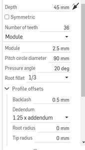

To generate the gear, we will use the spur gear tool we added in the last step.
For my design, the parameters for my gear were:
  1. 36 teeth
  2. 45 mm depth
  3. 2.5 mm module
  4. 0.5 mm backlash
  5. Helical
  6. Clockwise
  7. 15 degrees
  8. Double Helix
A larger module and depth will result in a larger gear and overall size of car.
Now that you have adjusted the gear to your liking, click the green checkmark to save and exit the spur gear generator.

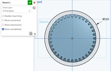

Creating a Circle (Example One)
Now that we have a gear to our liking, we must create a cylinder to subtract the shape of gear from.
Using the view cube in the top right, select the front plane to view the project from the front. This should give you a flat view of the flat surface of the gear.
Use the sketch tool on the left in the toolbar to create a new sketch on the front plane.
Usethe center point circle tool (c) to drag a circle from the center of the gear. It's okay for this to be an imprecise number.
Using the dimension tool (d), we can double click on the radius of the circle we just created and fine tune its size.
Click the green checkmark to save and exit the sketch once you are satisfied with the size of the circle in relation to the gear. The cylinder will be used as the wheel/tire, so keep that in mind.

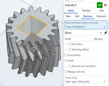

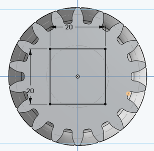

Once you have finished generating the gear using the spur gear feature, we must also make a square hole in the center to hold the wheels onto the car body.
Creating a Square Hole
For this example, we will sketch a 20 mm square, but you can do whichever size fits your gear.
Use the sketch tool on the left in the toolbar to create a new sketch, selecting the flat face of the gear.
Usethe center point rectangle tool (r) to drag a rectangle from the center of the gear.
Using the dimension tool (d), we can click on a side and adjust its size.
Click the green checkmark to save and exit the sketch tool.
Click on the inner part of the square so the entire square highlights orange, not one side. We will use the extrude tool (shift+e) again.
Confirm the extrude tool is marked as remove and not add. Adjust the depth to whatever size hole you'd like in you gear. I chose 25 mm.
Click the green checkmark to finalize the extrusion.

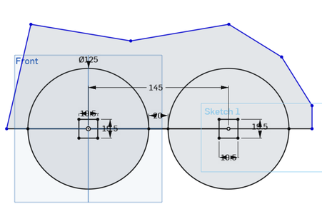

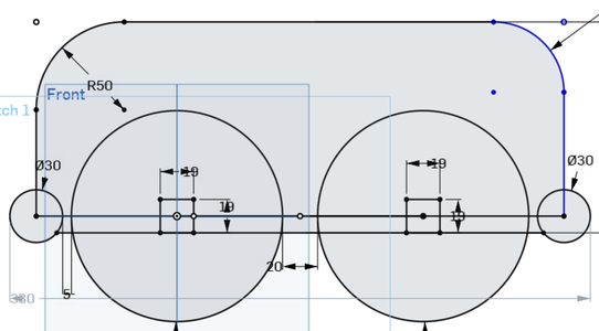

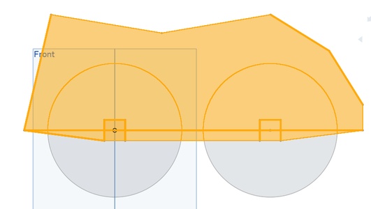

Step 4: Designing the Car Body
Designing the car body is where you can really let your creativity flourish!

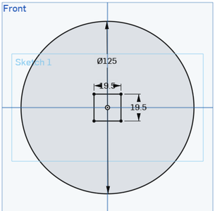

There must be adequate spacing between wheels and the car body. We don't want the wheels to rub against each other or the car body.
The wheel example has a radius of 110 mm, so we will sketch out a circle with a radius of 125 mm on the front plane.
In the last step, we created a 20 x 20 x 25 mm square hole in the gear.
To allow for some wiggle room, we will create a 19.5 mm square.
Now, create another 125 mm circle however far you'd like away from the other one.
For my example, I'll use 20 mm. Additionally, in my car, the distance between the centers of both circles is 145 mm.
If you have different dimensions, simply add the radius of the sketched circle and the distance between each circle to get this number.
Get creative with how you sketch out your car, make it your own!

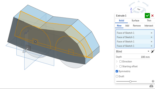

Solidifying the Car
Now that we have a sketch of our car, we will once again use the extrude tool (shift+e).
Select all the faces you'd like to extrude. (Example shown).
Since our wheels are 45mm wide, we will extrude out 100 mm symmetrically.
Adjust this number depending on how far you'd like the body to protrude or how much you'd like the wheels to protrude.

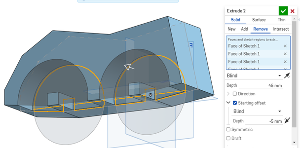

Creating Wheel Wells
Now that we have the body of the car, we need to create wheel wells.
We will hide the car body and use the extrude tool again to remove material to create space for the wheels.
Adjust the starting offset depending on the size of the wheels and your design preferences.
Since our car body is 100 mm wide and our wheels are 45 mm wide each, I chose a 5 mm offset to bring it all together.
Repeat this on both sides.

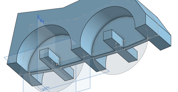

Cutting the Parts
Luckily, Bambu Studio has a feature called cut located in the top toolbar where you can split the part in half AND add connectors.
We will cut the gear in half as shown in Picture 1. In my case, Bambu Studio did not want to cut it straight in half so I adjusted the movement parameter to .10.
You can also add connectors to fit the two halves together. I'd recommend adding two connectors, each being a different shape. This will ensure the correct orientation for the halves when you assemble them. I have this shown in Picture 2.
Next, import the car body. It may not fit on the build plate depending on the size of your car, so we will have to cut it as well. Repeat the same steps of cutting and adding connectors. Connectors aren't as necessary for the car body, but it is nice to have the two halves interlock.
We will not have to cut the sun or planet gears.
