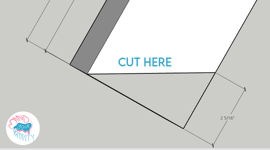

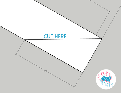

Step 5: Frame Diagram
This is the frame. I used glue and dovetail joints. I recommend using quality wood-glue and L-brackets at the bottom of the joint to reinforce it.
You'll be cutting along the line.
I used a dovetail joint which I glued and let set before I made the cut. Scroll down for those pictures.
