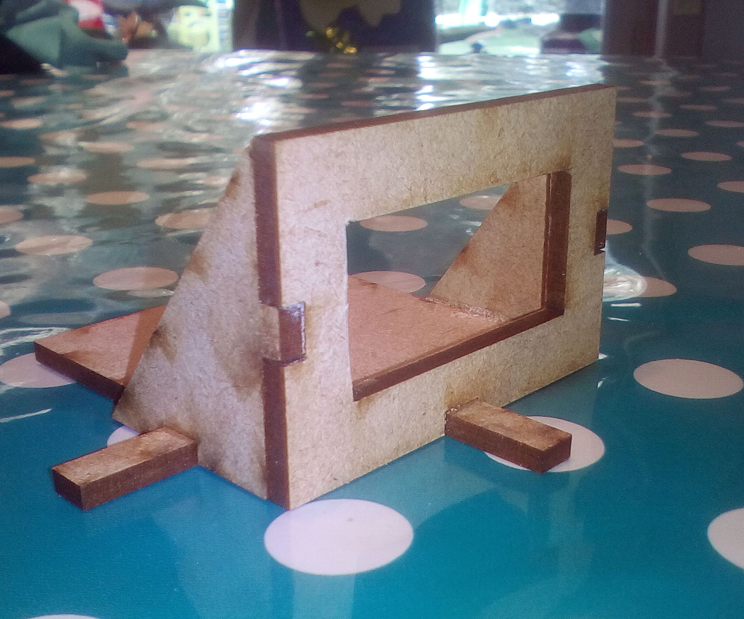

When you want to box something with a dedicated/customized box, this fully customizable 3D design in Fusion 360 can help you.
You can use this basic design, customize the length, width, height and even customize the number of fingers on each leg and the size of the fingers.

Step 2: Adjust the Basic Model in Fusion 360
The model can be fully customized, see the screenshot for the parameters to set.
- length of the box
- width of the box
- height of the box
- thickness: the material thickness
- lfingers: number of fingers for the length dimension
- wfingers: number of fingers for the width dimension
- hfingers: number of fingers for the height dimension
