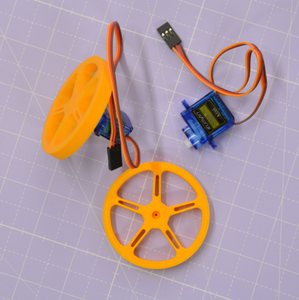

Step 5:
get wheels here or just download:🛞 Wheel for SG90 Servo・Free STL File for ・Cults
frame/chassis ⬇
