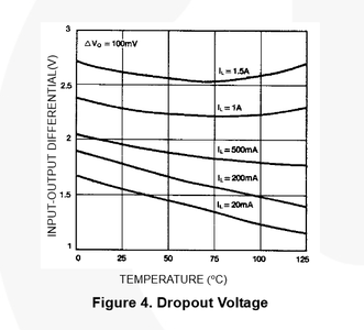

To calculate R2 you can use the formula provided in the first picture, Vout will be the maximum voltage you want to output, but take into account the maximum output voltage will never be equal to the input voltage, there will always be a small voltage drop of around 2 volts, this value will depend on the current the regulator is supplying (see table).
The value of R1 is 4.7 kOhms, you can use other potentiometer values, but don't use very resistive ones to respect the minimum current flow indicated by the datasheet. If the current is too low noise could increase and the voltage adjustment operation would be negatively affected.

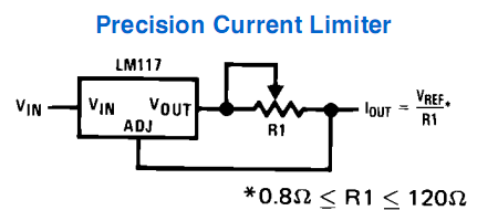

You can also add a current limiter in series with the voltage regulator, they are useful if you want to test delicate circuits, by setting a current limit the circuit will be protected against overloads in case of failure, which might save your circuit from being fried. I didn't installed it since I don't think it's really necessary, I was also already running low on space.
