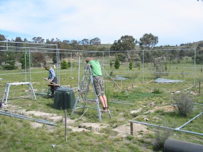

This is a project that my family and I started in 2008, and it certainly isn't finished yet. (do gardens ever really finish? There's always more weeding to do :)

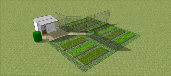

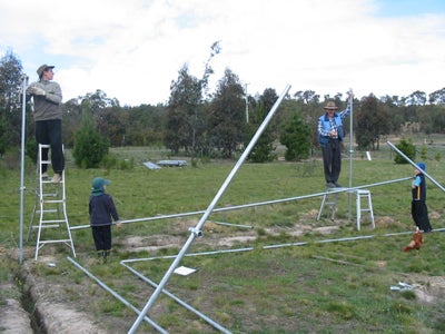

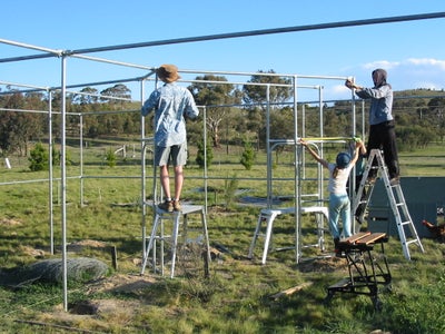

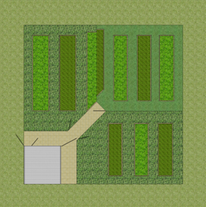

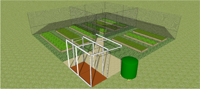

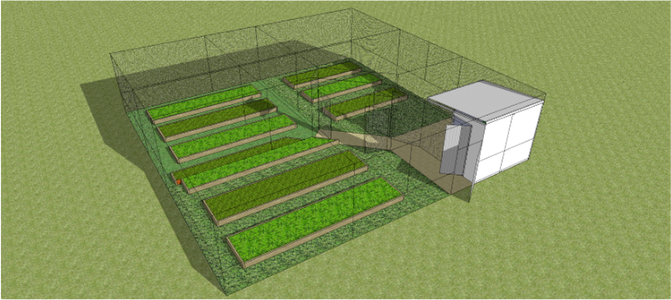

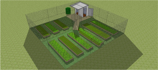

The basic idea behind the layout of the garden is that crops can grow in one area, while the chickens are allowed to dig through the soil in another, while the third section is prepared for the next crop to be planted later in the season.
I designed the main structure using Google SketchUp 6, and I'm still working out the finer details for the chook house/tool shed.
The SketchUp model can be viewed and downloaded from here.
