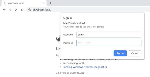

Step 16: Post-installation Tasks - Connect to PiWebcam's WiFi Access Point
Once powered on, the device will start acting as an Access Point.
Connect to the WiFi network created by the device. The passphrase of the network as well as the password of the admin user (for both the web interface and SSH) is the same as the SSID (e.g. PiWebcam-XXXXX). Point your browser to http://PiWebcam.local and authenticated with username "admin" and with password the same as the name of the network.
Step 17: Connect the Webcam to Your WiFi Network
I you want to connect the webcam to an existing WiFi network, go to Device / Network, select "WiFi Client" and fill in your "WiFi Network" and "Passphrase".
Wait for 1-2 minutes, connect back to your network and point your browser to http://camera_name.your_network (e.g. http://PiWebcam-e533fe.local)
