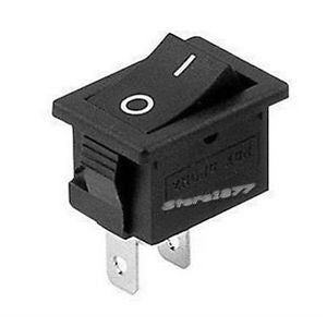

One Rocker Switch

Next Attach your base wood ( the 2 10" x 1 1/4" x 1 1/2" and one 2 1/2" x 5 7/8" x 1 1/2" ) together with screws make sure to cut the holes for your cable, switch and your cable to the fan. More info in the schematic picture.
