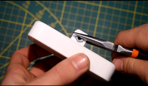

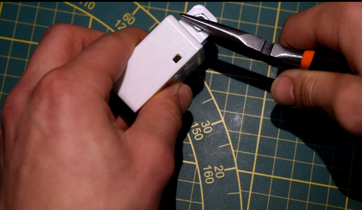

Step 2: Attaching the Arm
  1. Insert M5 nut
  2. put the arm between
  3. screw the M5*15mm screw
  4. Same on the other side
