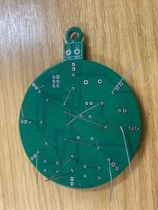

This year I wanted to design something with sound as well as blinking LEDs so I designed a bauble shaped PCB with blinking LEDs and a piezo buzzer. Check out the video to see it work.
Once again I used the venerable ATMega328p microcontroller as the heart of the project. This little microcontroller maybe getting a little old but it's simple, relatively cheap and widely understood and supported. I learned a lesson from last years project whereby I used the internal clock which required installing a specialised board on the Arduino IDE. This year I kept things simple and integrated a 16MHz external crystal so that the completed PCB can be treated as an Arduino UNO or NANO.

Step 1: PCB Design
To design the PCB I used two software packages, Fusion360 and KiCAD. Fusion360 was used to design the custom shape of the PCB and KiCAD was used add the components and connecting wire traces.
There are multiple PCB design tutorials online for Fusion360 and KiCAD and other PCB design software packages.
I have tried to keep the design very simple and easy to understand. The schematic features an ATmega328P microcontroller powered directly by two CR2032 coin cell batteries (3V each in series, providing ~6V). The microcontroller operates at 16MHz, stabilized by an external 16MHz crystal oscillator and two 22pF capacitors connected in parallel to ground for proper clock operation. A piezo buzzer, connected to a GPIO pin (Arduino pin 3), outputs sound based on the code's tone generation. Eight LEDs, driven by individual GPIO pins (Arduino pins 4 to 11), provide visual effects. A push button (SW2) connected to a GPIO pin (Arduino pin 2) with an internal pull-up resistor is used for user input to start the process. Push button (SW1) is connected to the reset of the micro controller which turns all the LEDs off if pressed. This design was utilised to eliminate a voltage regulator to maximize simplicity and minimize power loss.

When I solder the components to a PCB I usually start with the physically lowest components (such as the resistors) and then work up to the highest components (the LEDs) as it makes it easier. The order I soldered the components was:
- 8 x 1K ohm LED
- 1 x 10K ohm LED
- 8 x LEDs
- 1 x 16MHz Crystal (the metal component that's a silver lozenge shape)
- 2 x momentary push buttons
- 1 x 100nF ceramic disc capacitor (orange and marked 104)
- 1 x 2x3pin male header pins.
- 1 x Piezo Buzzer.
- 1 x 100uF Electrolytic Capacitor
- The Screw Connector on the back.
- The battery pack power leads.
On the front of the PCB all the resistors are 8 x 1K ohm resistors near the LED positions (R1 to R8) and need to be positioned in their holes. Once I've pulled the leads through I bend them outwards at 45 degrees to stop the resistor falling out of the PCB. I then solder all the leads in place and trim off the excess lead.
To solder the connection remember to heat the connection of the PCB and the lead and then feed in just enough solder to make a neat joint. Then pull the soldering iron away and let the joint cool making sure not to move it.
The resistors are there to limit the current going to the LEDs and prevent it from becoming damaged and failing. They also mean your battery can last longer. When you place the resistors on the PCB in doesn't matter which way round they go. The 10k ohm resistor on the back is to prevent the microcontroller resetting by holding pin 1 high.
The LEDs are a diode which means current can only go through them in one direction so it's very important they are put in the correct way round. An LED has two wires from it, usually called legs, and one is longer than the other. the Long leg goes to the positive and the short leg goes to the negative. If you look carefully at the PCB the LED position has two holes. One hole is surrounded by a square shape, this hole is for the negative LED lead (the short lead).
I pre-soldered the crystal onto the PCB for my hackspace members so that I could pre-program the microcontroller with the bootloader. If you solder the crystal yourself it does not matter which way round it goes but I prefer to see the writing on it the correct way up!
When soldering the capacitors it does not matter which way round you solder the small ceramic disc capacitor (C3) however it's very important that the electrolytic capacitor is soldered the correct way round. The shorter pin with the white stripe on the capacitor needs to be put in the hole for the negative terminal, this is marked with a white semi-circle.
The two momentary push buttons will only fit one way round so it's important that they are placed correctly. You may have to bend the pins a very small amount but not too much.
The Piezo Buzzer also needs to be installed the correct way round. Make sure the + terminal on the buzzer is placed in the hole marked with a + symbol.
A really useful tip for soldering components to a PCB is to place them in the correct position and then hold them there temporarily with blue tack. This enables you to turn the PCB upside-down without all the components falling out. This is how I soldered the microcontroller socket.
When you finally solder the battery pack power leads ensure the red wire goes to the positive terminal and the black wire goes to the negative terminal. I held the battery pack in-place with some Blu Tack but you could use hot glue or double sided tape.
