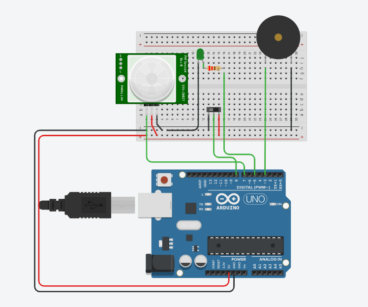

Step 2: Assemble Your Circuit
With the help of the schematic above build your circuit in real life with all the required components, for additional help here's the link to the public tinkercad circuit :
https://www.tinkercad.com/things/1DU3sCunuE2-final...
- Start off by completing the wiring on the breadboard to help avoid wrong wiring
- Next, insert the five 560 ohm resistors in the middle of the breadboard (ensure to follow the wiring and location of each component according to the ones in tinkercad to prevent the circuit from not working)
- Following the resistors insert your pushbutton near the top of the breadboard above the resistors in the same pin located as the one in tinkercad
- Add each led in the order of red, yellow, green, green, and red (colors of the led can be changed according to your choice however change the name of each component in the code to avoid confusion)
- With the wiring and most of the components done follow up with the buzzer that will be responsible for making the timer go off, with the help of the two male to female jumper wires attach the buzzer and locate one side of the wire in the Arduino pin 8 and the second jumper wire will be attached to the breadboard (Look at the tinkercad for a clearer idea of the location of the pin).
- Finally, with the wiring is done and all the components attached make sure to review the wiring and ensure its the same as the one in the tinkercad to avoid troubleshoot and the circuit failing, unless you would like changes of your own which would also require you to change the code accordingly.
