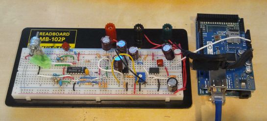

Step 2: The Circuit
It is time to wire everything together!
You will need for this step:
- Your array from the previous step
- Breadboard and Arduino
- Regular 10-30kOhm resistors
- The Servos
- Wire / Strippers / Cutters
Essentially you are replicating the image below.
- Place the Arduino on one end of the breadboard, I chose to tape mine down with electric tape so I don't knock my wires out or something like that, just remember to poke holes through the tape for your wires if it goes over any of the pins.
- Run a wire from the gnd and 5V pins to the ground and source lanes of your breadboard respectively. I also like to connect the source/ground lanes on one side of the board to the other, but that is just preference.
- Place your 22kOhm resisitors as shown, going from one lane each to ground. I snipped my leads so that they fit snugly on the breadboard. Then on the same lanes as your resistors, run 5 wires (1 for each resistor) to analog pins 0 to 4 as shown; it helps to keep it organised. The resistors will help to divide the voltage and gives a good reference point.
- The servos are next. The wires coming from the servo will vary depending on make and model, but it's usually safe to assume the red is power, the black is ground, and the wire that's left is the signal. The middle pin is, as far as I know, always the power. The signal wire can be white, grey, orange, and yellow. Sometimes there will be 2 black wires and a grey one. The unique wire is the signal, the middle is the power, and the other is the ground. The servos go into source, ground, and the signal wires go into pins 11(for x values) and 10(for y values).
- Last but not least, the photorestors must be plugged in. If you followed the last step and lined up your photorestors in C.R.L.U.D. order, just stick them into the same lanes as the resistors and Arduino analog pins. The red wires coming from the other leads of the photorestors simply go straight into the source(red) lane.
- At this point the circuit should be functional. Get the code from the last steps and see if it works!
