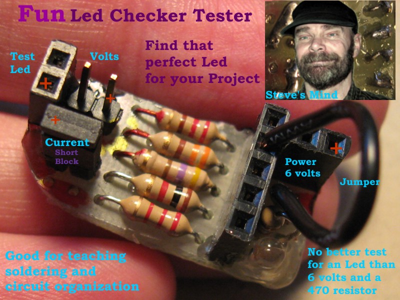

Lighting multiple LEDs is easy just add up the voltage and the current of each LED to match your power supply and or your transistor. You connect them Cathode(-) to Anode(+) down the line. You can test your LEDs with my ‘Testing an Led’ picture and document. LEDs need about 2 volts and about 2-6 mA each to work. 12 volts lights about 6 LEDs.
