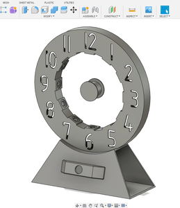

Step 1: Designing It With Fusion 360

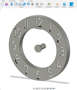

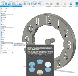

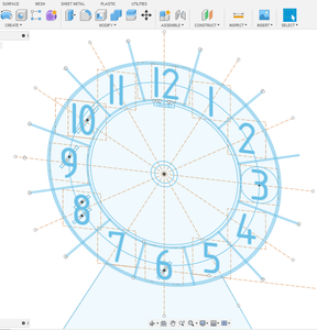

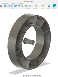

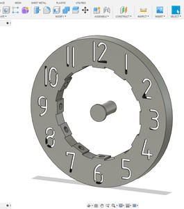

This clock was designed using fusion 360, basically it is a hollow cylinder with text, the thickness of the walls is 2mm.
I used circular pattern to create the holes for the rods.

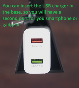

The base is hollow to put the usb charger and the ESP board.

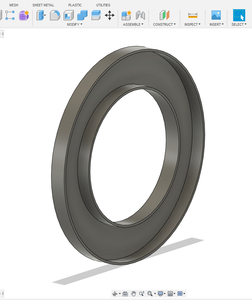

There are Two back covers. You can use the one you like or just leave open the back.
The diffusers can be 3d printed or you can use just paper.

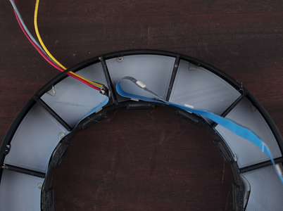

  2. Solder the cables on the LED Strip, you will need to add a small Resistor (100Ohm) between the Data cable (center pad) ann the Dupont Cable that goes to the ESP32 (or ESP8266).

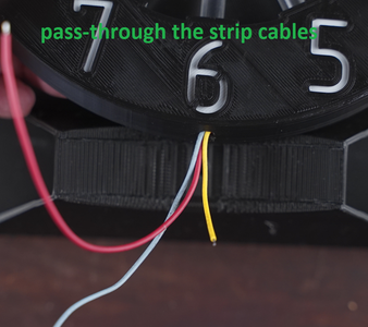

  3. Pass through the cables in the bottom hole of the clock.

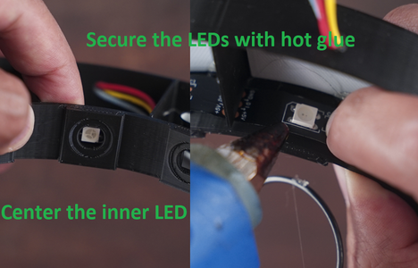

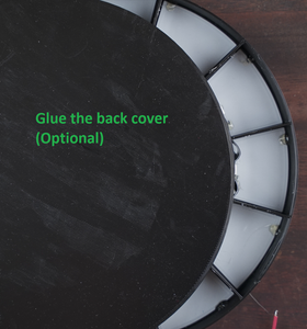

  4. Use hot glue to place the LED Strip, Remember to arrange the LEDs of the strip that light the numbers goes clockwise.
  5. Glue the back cover (Optional). You can leave the clock without the back cover because it will light the wall behind the clock if you want.

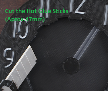

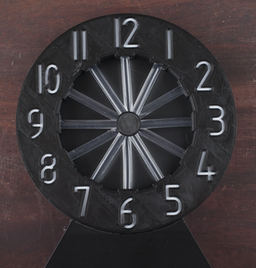

  6. Cut the rods. Using a small saw of a hobby knife cut the rods in the right amount (around 47mm).
  7. Glue the rods using hot glue, place the rods in the center of holes so the LEDs lights the rods.
  8. Place and glue the center piece.

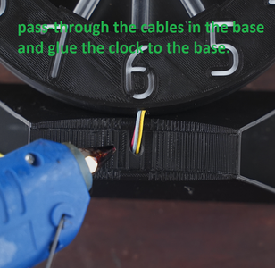

  9. Pass through the cables in the base hole.
  10. Glue the Base to the clock.

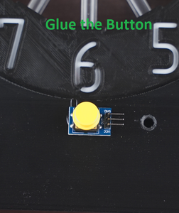

  17. Connect Vcc Pin of the Button to GPIO17 of the ESP32.
  18. Connect Center Pin of the Button to GND of the ESP32.

  20. Place the ESP32 (or ESP8266) and the Charger inside the base.
  21. Glue the Button cover.

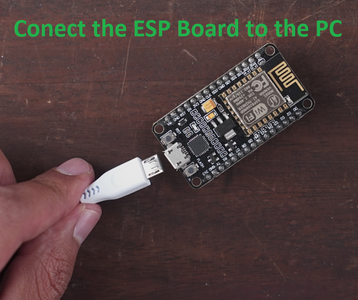

  • Connect the ESP32 or ESP8266 to your computer using a micro USB to USB cable, wait for the driver installation or download the drivers for your board:
CP210X USB to Serial Driver
CH340 USB to Serial Driver

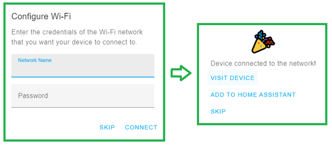

  • Enter your Wifi Network Name and Password so your ESP is easily configured.
  • Click on VISIT DEVICE so the installation page will direct you to your new WLED device.

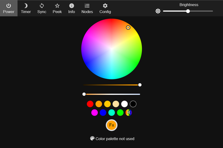

Step 4: Configure the Clock in WLED
Go to the Config Menu and then LED Preferences.
  1. Select the length of the strip: 24
  2. Select GPIO button: 17
  3. Click on Save.
Go to the Config Menu and then Time & Macros.
  1. Select your time zone GMT.
  2. Find in Google what it is your Time zone. (or you can click on the Get location button).
  3. For me it is GMT-4 (GMT minus 4 hours, so I have to enter the correction in seconds. -4 hrs x 60min x 60 secs = -14400 secs)
  4. Scroll down to Clock Title and configure the next.
  5. Select "Analog Clock Overlay"
  6. First LED: 12
  7. Last LED: 23 (23 because we start counting from 0 up to 23 - total 24 LEDs)
  8. 12h LED: 17 (17 is the LED that will be the 12Hr in our clock)
  9. Select "Show 5min marks" (you can unselect this if you do not want showing seconds)
  10. Click on Save.
  11. It is done! You can see the clock already working.

I will go to the color wheel and select warm light, solid, and maximum brightness. Then I will go to preset tab and save the actual effect as Label ID 1. (this will replace the last preset number 1)
Then I will select my favorite effect like Chase Rainbow and save it as Preset Label 2 to replace old preset number 2.
