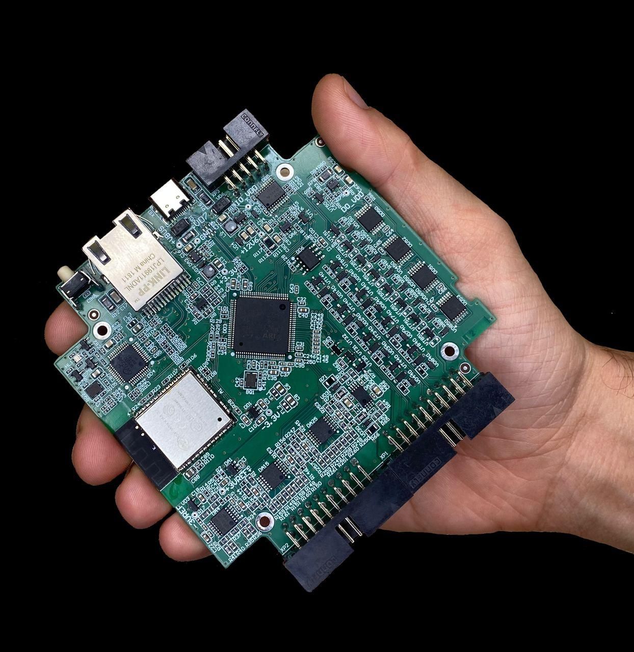

FORK - the tester
  • Supply voltage 5V
  • 8 Digital Outputs can be used as active/passive output, connect a relay or PWM on every channel
  • 8 Digital Inputs can be used as dry contact with input voltage up to 30V, with frequency measurement and pulse calculation features
  • 8 Analog Inputs -10..10V with overvoltage protection. One diff channel . Up to 1M Sample rate
  • 2 Analog Outputs 0..10V output with short circuit protection.Sin/triangle/saw/random wave generator features
  • 3 UART, SPI or I2C for connection with external devices like ADC, DAC, external memory, sensors etc.
  • Ethernet, Wi-Fi to connect with computer, RPi or Smartphone for total galvanic isolation

Compatibility board
This board is used to place a Pogo-pins for connecting to the device under test (DUT). It contains shunts for measuring current consumption, resistors for calibration, and relays for switching them to DUT. We develop the compatibility board separately for each DUT, so you will have to do it yourself.See how simple it is. It will take you less than one day to design it!
Step 1: Stand on the Fork
When the board comes out of the assembly line at the factory, it must be tested. We do this using a Fork that connects the board with needles. Here is a real stand of a real NOTA device.Fork manages:1. Measuring all important voltages on the board.2. Connecting the reference RC and measuring their impedance (the stand evaluates the difference between the measured and the standard and decides whether the board is working or not).3. Checks the Bluetooth functionality.
